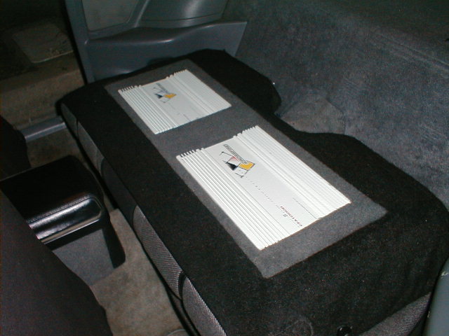

Audiobahn, BLAH!!!!!!! Sorry, had to post that. In the 6 months that I sold Audiobahns, 50% came back blown up. Big price for some chrome and a crappy speaker/amp. Here are some pics of the setup I built for my car that obveously clear my straps...
enjoy.

My first amp rack i built in my seats was similar to that. I had it all flushed in with the seat. However, when one of my amps proved to be defective, I was really upset to realize i had to remove the seat to remove the amp. If you look back at my pic, you'll see the grey bezel, well, removing that makes taking out an amp or adjusting a breze. Live and learn. The whole setup took me about 3 hours to make. Including the rebuilding of the seat for the bezel. Ive been offered up to $300 for the seat WITHOUT the amps. I considered making these to sell, but its impossible without having the amps for fitting. One thing I did do for when I go racing at the strip, All wiring and RCA connections are made via Mulex plug under the side panel, the power connections simply use distribution block. So when I want to go racing, undo the 2 bolts on the seat and uplug the plug. All ready to race...
