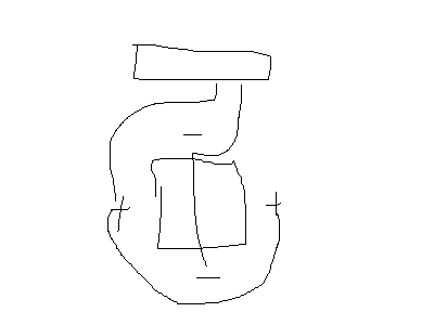

is it safe to bridge a 4 ohm dual voice coil sub? i have a 2 channel 1000 wat amp, and i want to put all the power into one sub and just buy another amp for the other sub... if its possible.
sorry if this is a dumb question, im just trying to work with what i have
This pic is something along the lines of waht i had in mind. Maybe wired differently whatever gives me the 2 or 4 ohm load i need.

hmm 2 ohm bridged is no good, my amp would melt.
I would have to have it 4 ohm bridged. or 2 ohm stereo.
Do i have any options?

in my manual it says it puts out hte same power bridged at 4 ohms as it does with 2 ohms, but it doesnt say anything about 2 ohms bridged on the site.

If it doesn't say anything, then that means the amp isn't stable at 2 ohms bridged.
You need to run your subs like this.....
