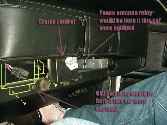

this connection will be at the top of the unit and NOT VISABLE with the hush pannel removed, you will need to pull the unit and allow it to hang by the connector in order to see it. this unit is about 6"X6"X1" if that helps. it is the smallest "amplifier" i have ever seen.if you are still unable to find it i can go snap a picture...
EDIT*well i found a picture of the area, i took the image of my 86 that did not have UQ7 and edited it to explain. here it is:

ahhhh... ok will this gives me a good fuzy on the location so i can go hunting and pull exactly waht i need.. thanks tony
