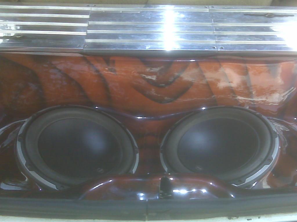

well i got my whole rear hatch area fiberglassed and made room for 2 JL Audio W6 subs And 3 amps
Old Jun 30, 2010 | 02:37 PM
jr32712's Avatar
Joined: Jun 2010
Posts: 8
Re: sub placement
1985 Camaro
