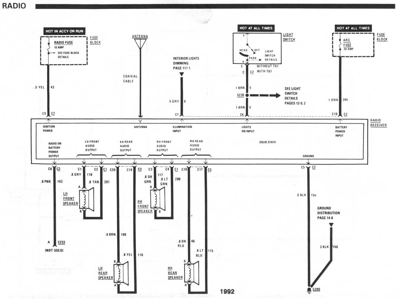

LOL, no the radio has a wire hooked to the ignition switch circuit so the radio will only have power in the start or accessory position. all radios wire up the same this schematic is from 92 so im not sure if there is any wire color change but as you can see in this picture the wire is brown.
You mean run or accessory.
The accessory wire is yellow, not brown.

Does the yellow accesory wire apply to all third gens?

Re: Radio Draining Battery
your right
