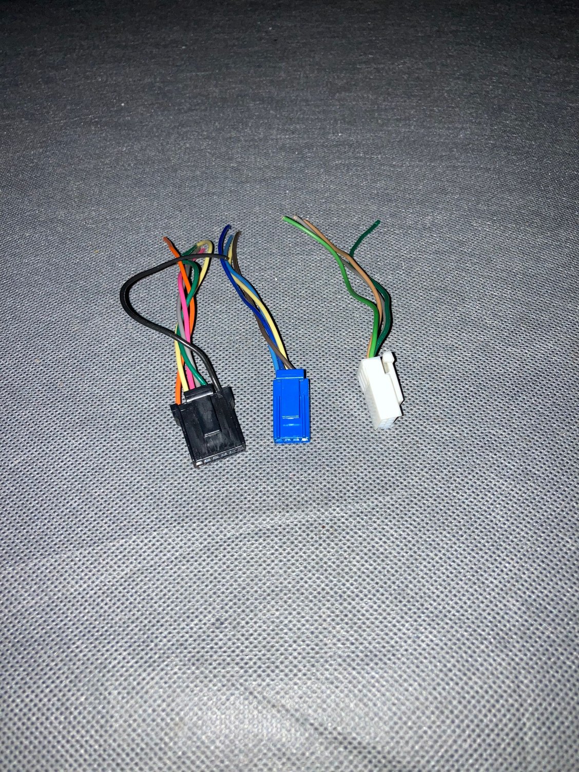

John....I personally prefer these 3 single connectors

Same here Mark, makes it easier to check specific things when testing or installing.
Funny thing; That set in particular isn't from a Thirdgen ( Buick maybe? ); You will not believe how many people get 'tripped-up' by that green wire !!! (Them = "It doesn't match my harness !?!?" Me = "Just splice to Brown and your G-T-G !" )

Yes these are from an early-mid 90’s Buick
