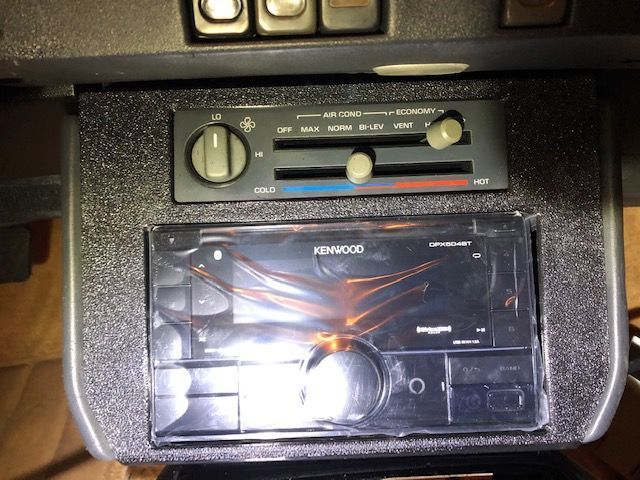

I was having the same problem until I found a guy that prints 3D double din face plates. (flowstateman.etsy.com) I got one in the mail last week and the fit is outstanding. I did need to remove some of the ABS material behind the stock radio once it was removed. Currently I'm working on securing the radio in the slot. I have a double din sleeve, but I don't believe the sleeve will fit but I will figure something out. I may buy another face plate to see if it can be sanded and painted. In the pictures I didnt snap on the framing face plate, this effort was to simply see if I could fit the double din in the car! Very happy!!!

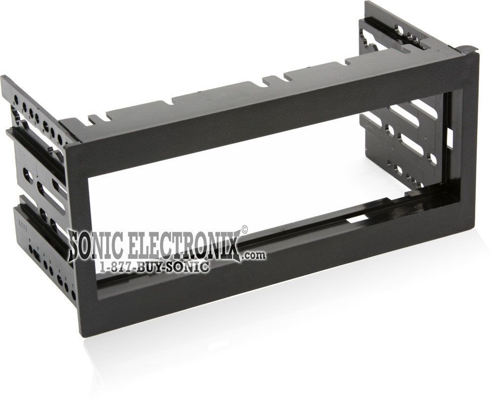

All you need is a 1.5 din to 1 din dash kit. I like the flush fit Scosch GM1500B over the ones with the protruding "nose".
https://www.sonicelectronix.com/item...0B-GM1500.html
