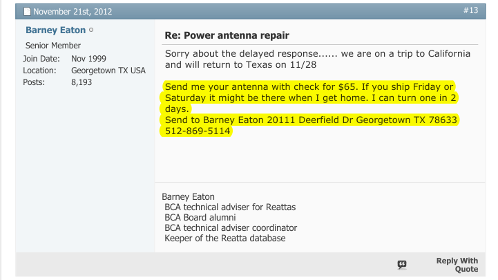

Below is a link I put up last year about my factory antenna swap. Barney can rebuild your antenna back to better than factory spec.
https://www.thirdgen.org/forums/car-...r-antenna.html

Barney did mine. Note the date on that...pricing may have changed.
I went through the install process (and several other repairs and upgrades performed at the same time) on my care HERE.

Talked to Barney yesterday. He's still at it, but the email address that he uses has changed. He can be reached at barneyeaton1@gmail.com for anyone wanting to inquire about his services.

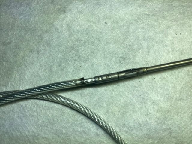

I just answered another post on this forum..... they were discussing the "Crown" replacement.
Also I do use plastic coated steel cable. I have no secrets so if you want to try and do your own contact me and I will walk you thru the process.
The one thing you must be able to silver solder..........the bottom of the Delco mast is stainless and very difficult to use regular solder.
I also buy my wire online and it is stainless that is used on modern open stairs (usually commercial) but plated steel wire cable will work.

Just wanted to say thanks to all involved in this Thread. The antenna mast snapped on the 89 GTA yesterday & while I have done mast replacements on my 2nd gen Trans ams, I wasn't sure if I was going to be able to buy a new cable kit, or maybe have to settle for an aftermarket antenna.
Then a quick TGO search landed me on this thread & I thought, "thats a hell of an idea" So I stopped & picked up some 3/32" cable this afternoon & went to work. The repair worked perfectly!! I did drill out the two dimples on one side that held the nylon cord. This gave me a great location to feed the solder in.
Never thought I would have this fixed this weekend, so thank you.
I will say the repair was the easy part, It's getting the unit R/R'd that was the pain in the butt

The only comment I have......... on the mast end, chamfer the plastic or sometimes it will get caught when it tries to go UP There is a plug in the bottom of the mast and that plug has a hole where the rough end could catch.
Otherwise.... good job
