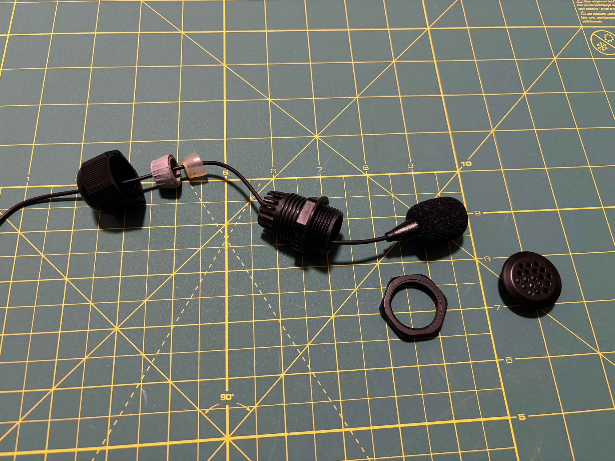

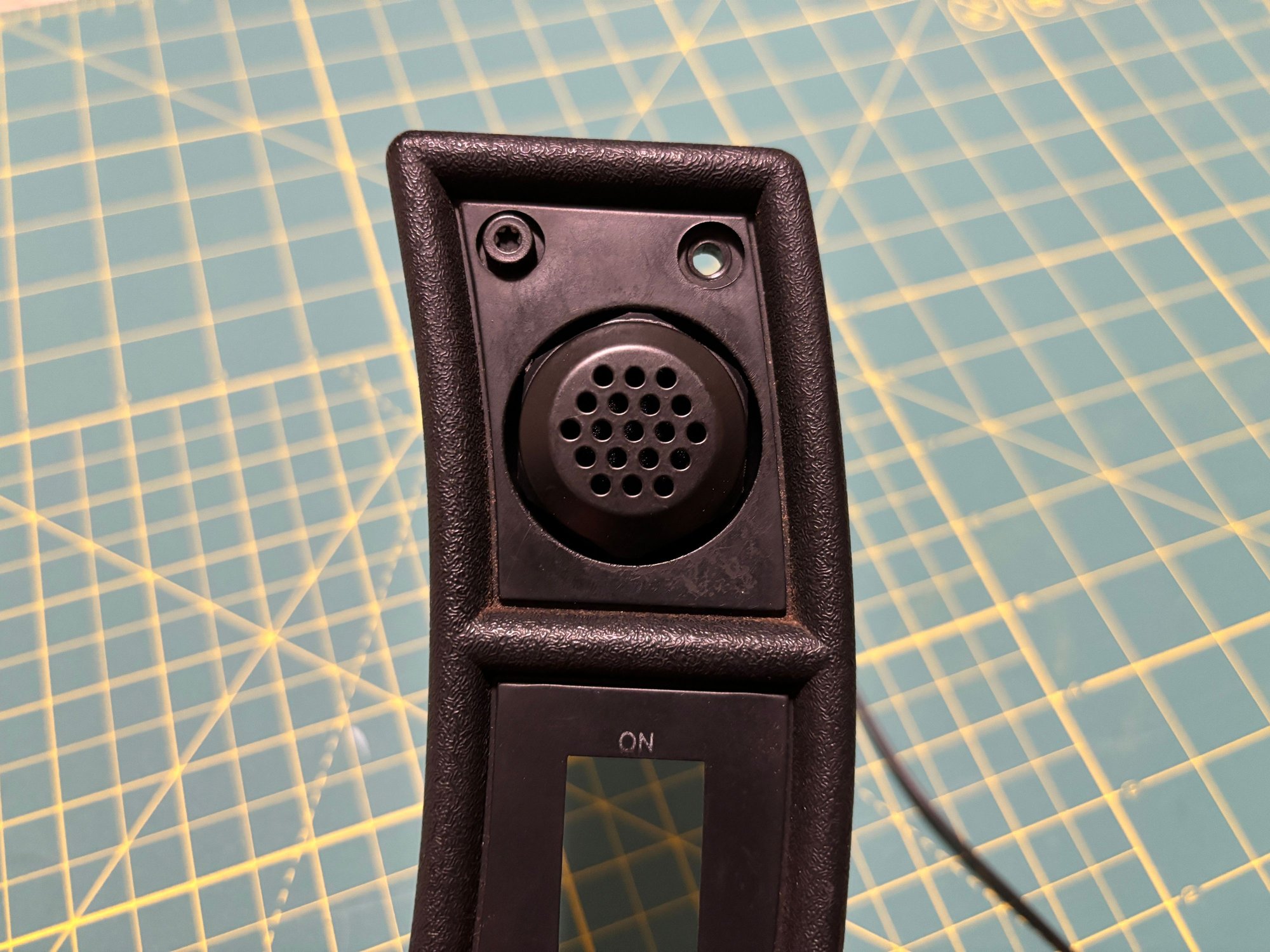

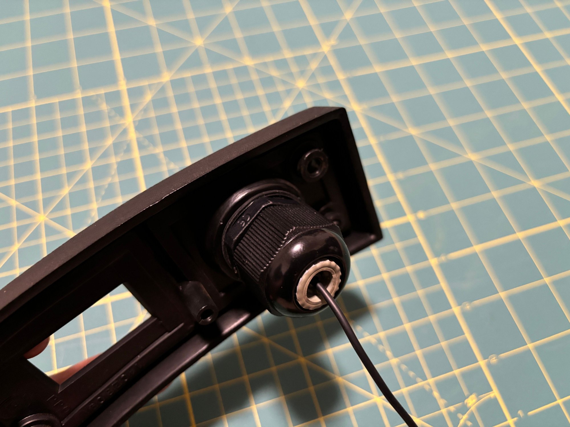

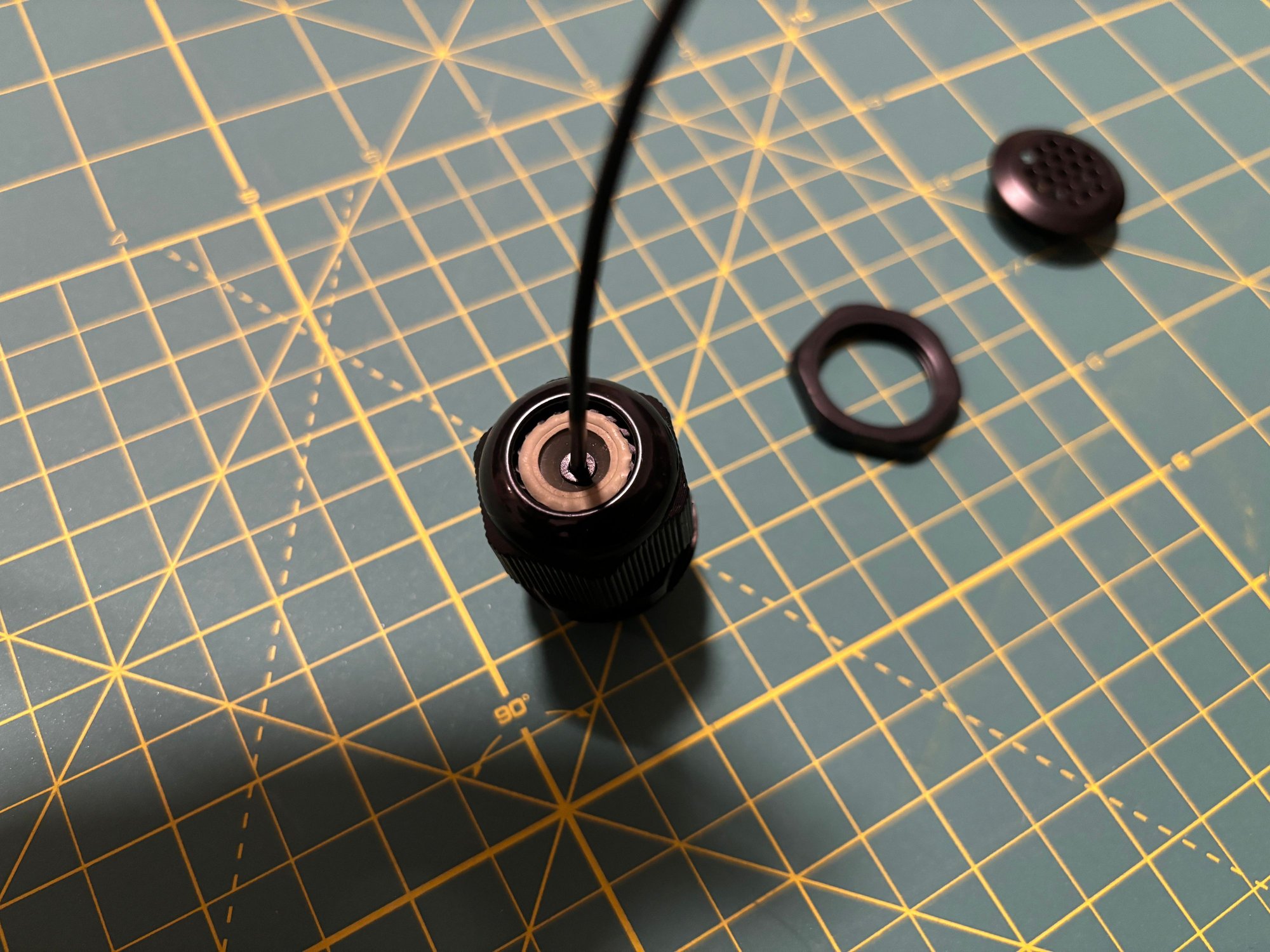

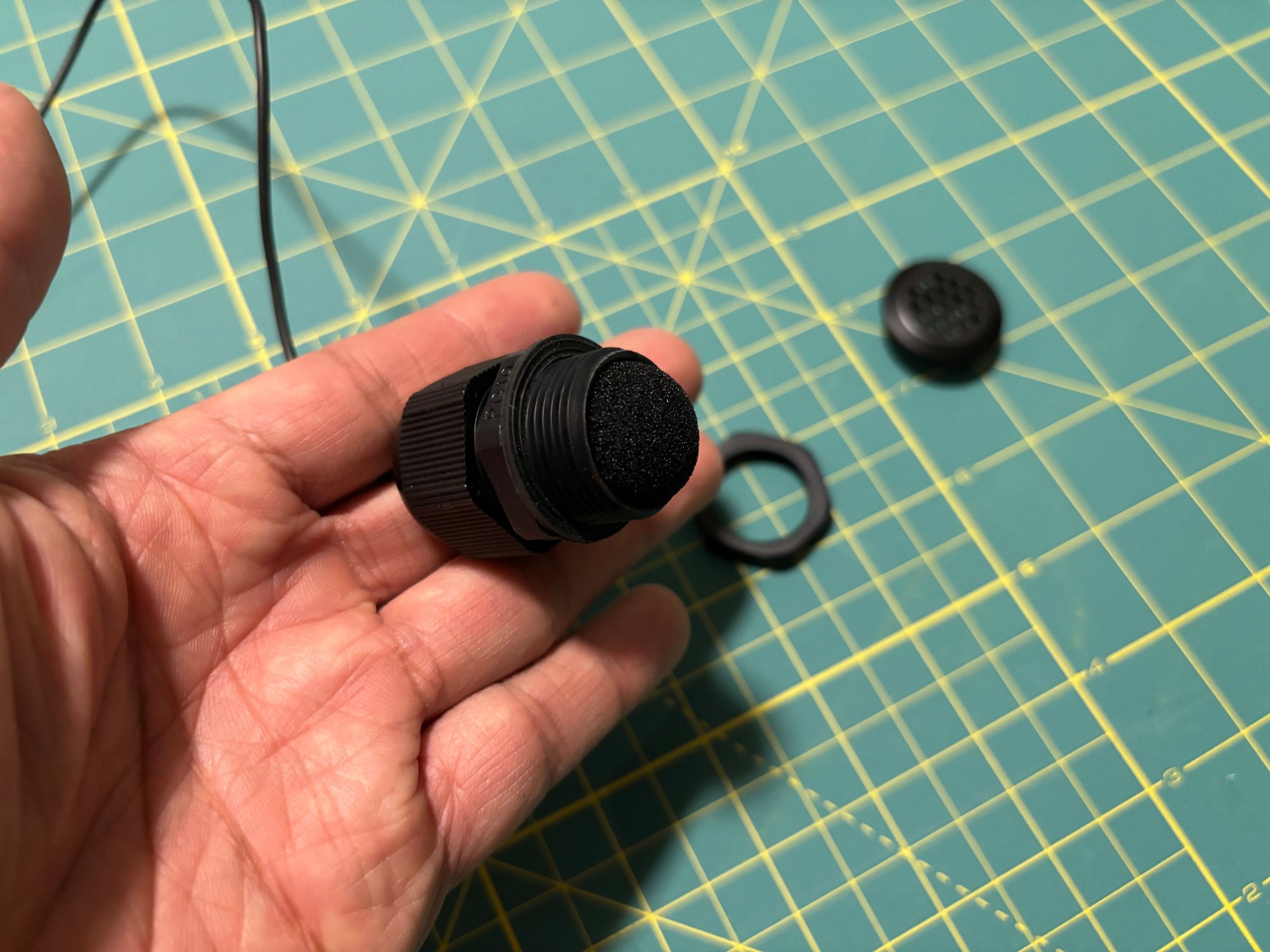

Microphone mounted in cigarette lighter socket.
Raided the parts bin at work and cobbled this together with a cable gland and soffit vent. 100% reversible. Just had to slightly sand down the threads of the cable gland to fit in the hole.

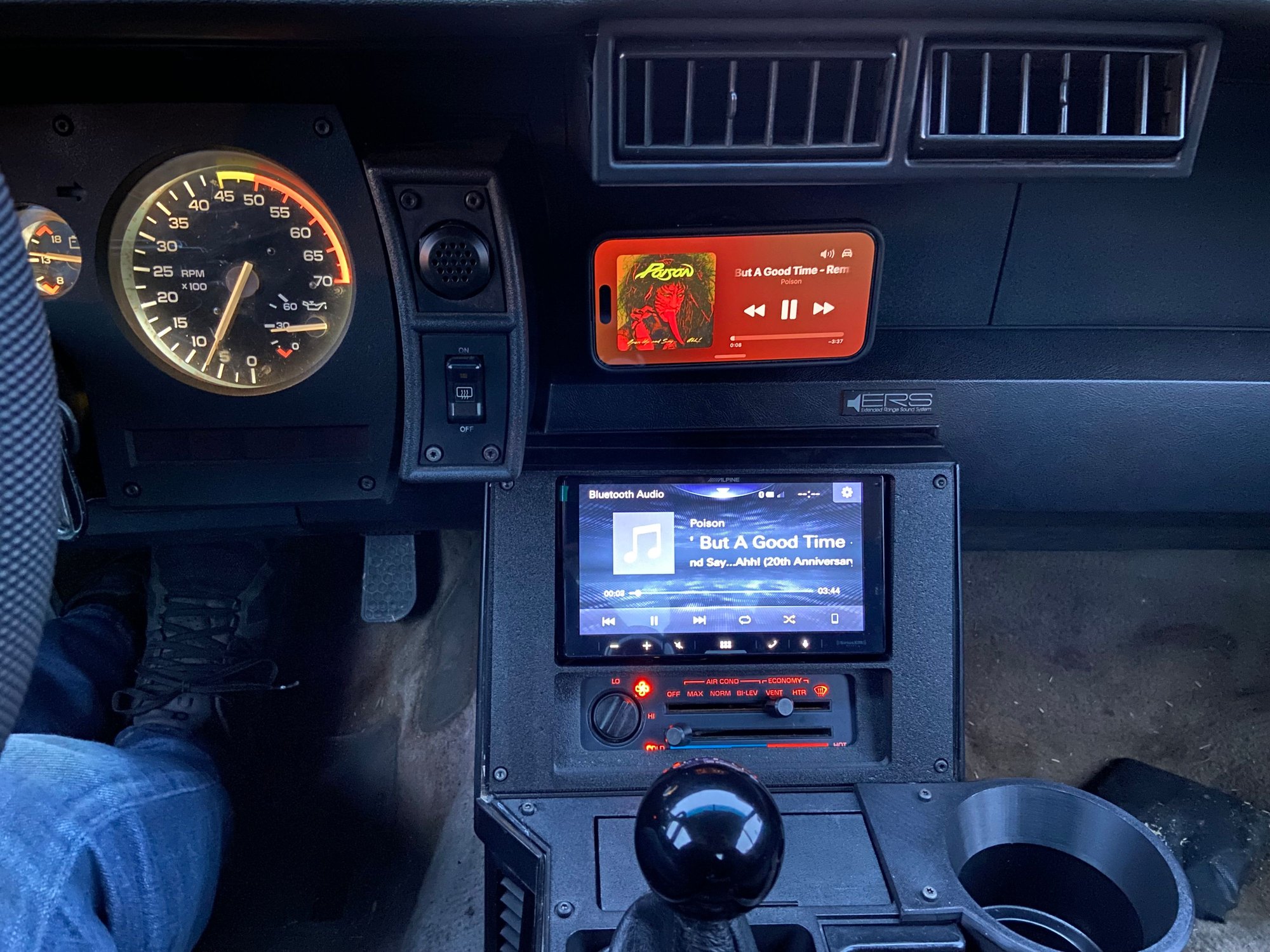

Is that for handsfree calling?
Yup. Quality isn’t great, but as loud as the interior is, it’s not much worse than when I had it on the visor.

I use an iSimple bluetooth FM modulator for hands free calling in both my TA verts, and the Mike is mounted at the top of the driver's A pillar. Even top down, I can easily carry on a conversation.

Vent from Amazon. 0.8”:
Amazon Amazon
Can’t remember the gland size exactly. I just tested a few at work until I found one that fit. I think it was an NPT 3/4”
