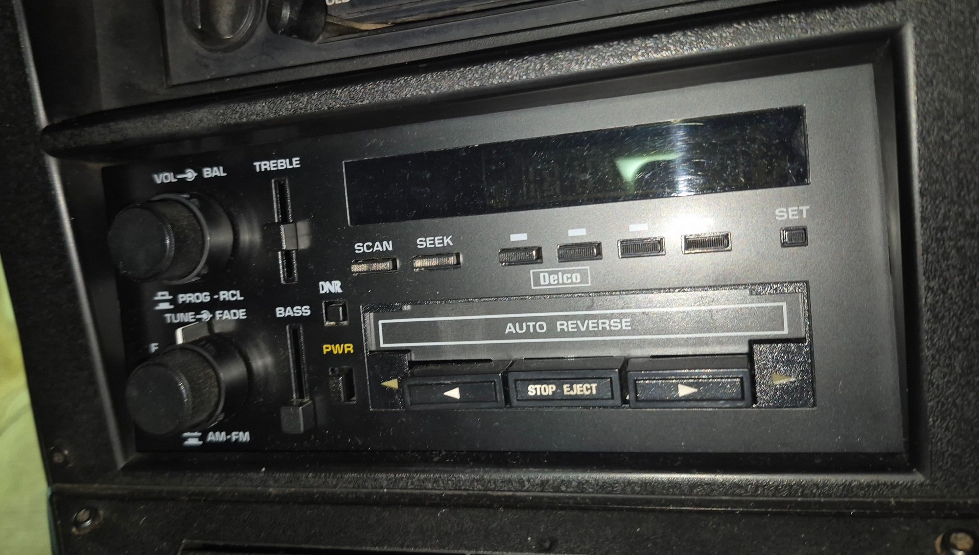

What are the best speakers to put in a 84' Z28?
This is just a general question for the 3rd Gen public, but what speakers are the absoulute best to install into a 3rd Gen (specifically in my case an 84' Z28 Camaro) with the factory head unit/radio? This one here:
I'm not looking to upgrade the head unit because it was referbished with a brand new cassette motor, but wondering what everyone else running the factory head unit has for speakers if they replaced the stock ones. My car had aftermarket Pioneers (from god knows when) that were blown out in the back when I bought it, and a few months later the dash speakers went out as well.
Provide links to your speaker products if you can!
