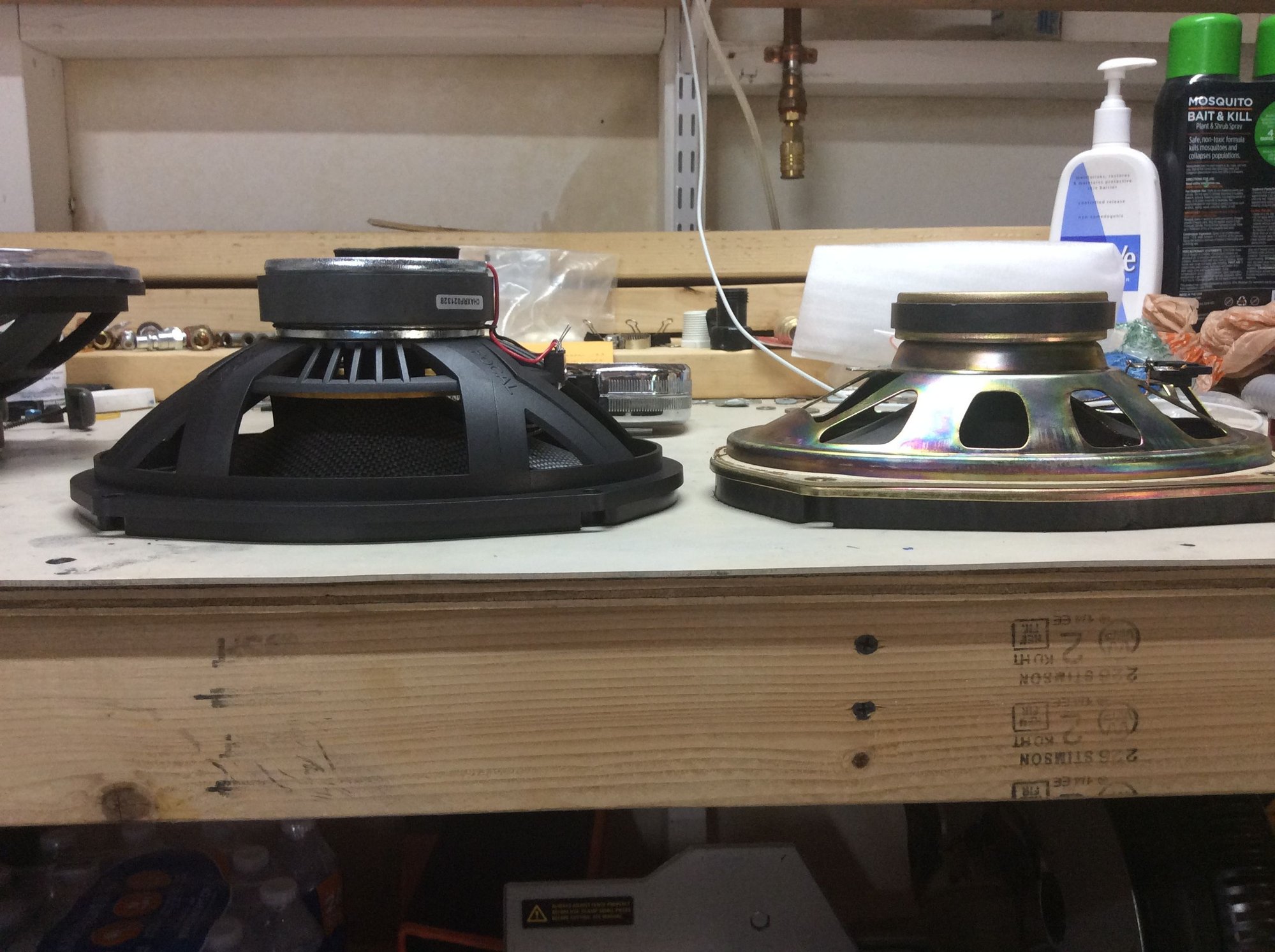

Hey fellow TGO'ers - Would you mind posting what speakers you have installed that was a drop in replacement while using stock head unit and also if you like the sound quality. Also year and if firebird or camaro. its my understanding the firebirds have less space to work with up front.
Its funny, I had a pair of Infinity's that were awesome sounding 6x9 3-ways from the 90's that I was going to put in my Firebird one day. Put those in storage along with my Bird 25 years ago. Only the factory firebird speakers survived, the infinities crumbled to dust.

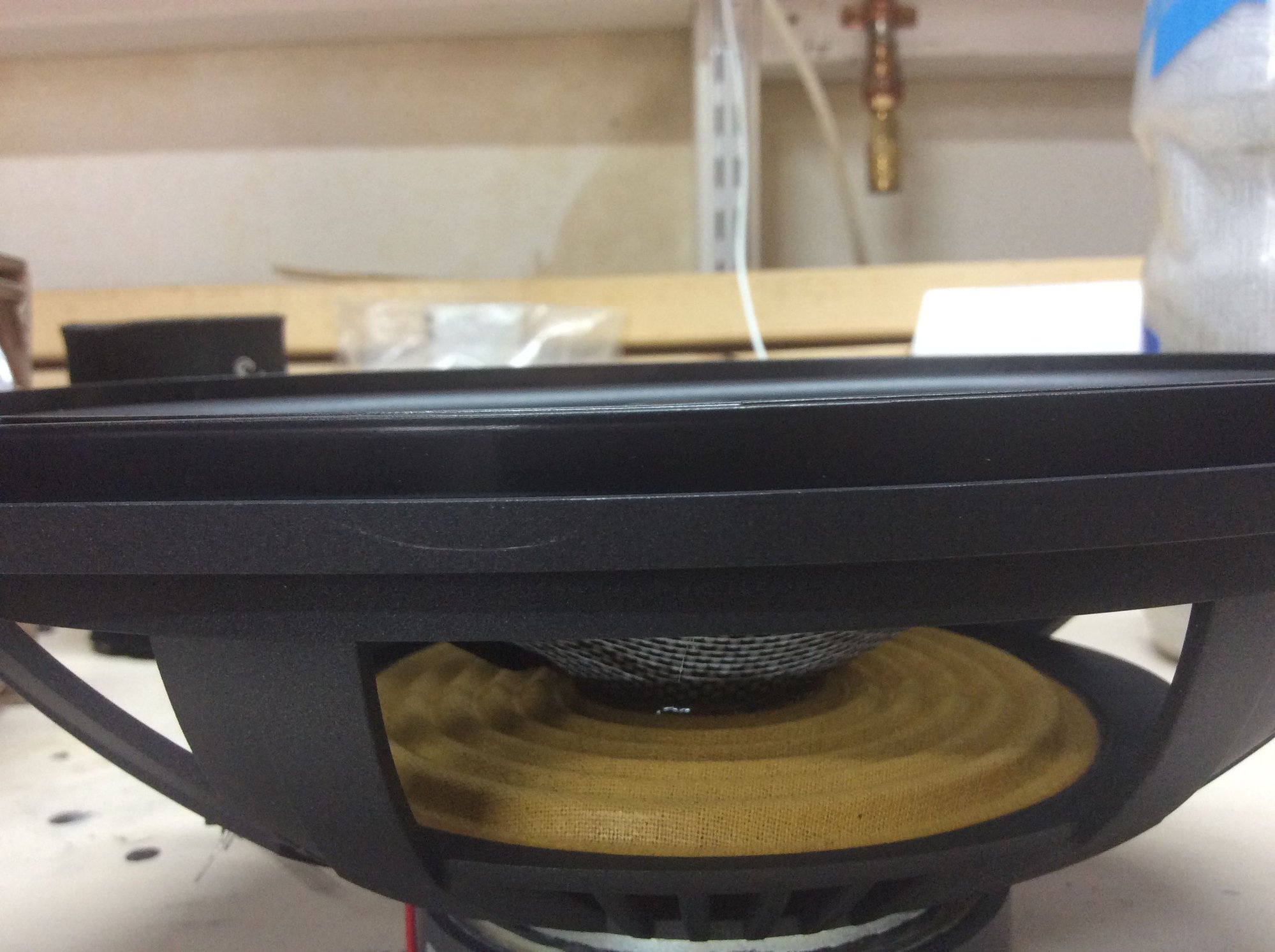

P.S. Does anyone know the mounting depths available for firebird speakers up front, and also the rear?

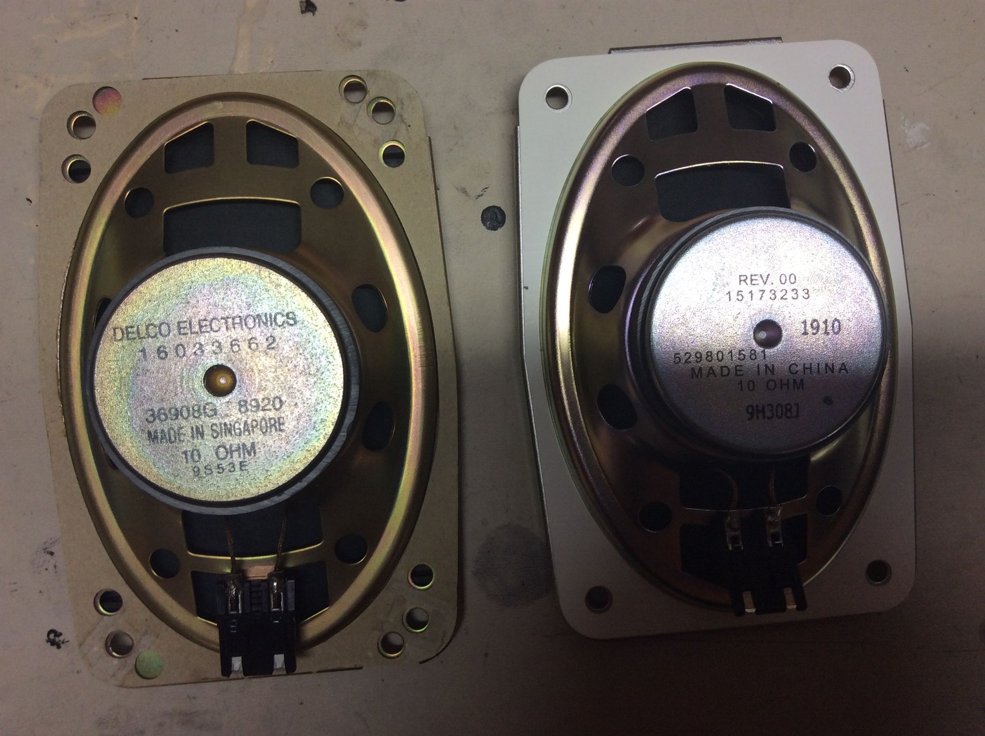

LiquidBlue: My opinion on speakers for a 4 speaker system in a Thirdgen is this: DON'T USE 3-Way speakers in the rear !!
** Factory stock Thirdgen head units are made for 2-10 OHM front speakers and 2-4 OHM rear speakers. Each of the internal AMP CHIPS controls 1 front and 1 rear speaker.

Those are pretty basic speakers - but yes; that's the idea. I'm not a novice when it comes to sound systems - but I'm no pro either. The factory Delco 2000 radios (with EQ) are adjustable from 20HZ to 10K so just be sure that replacements cover at least that band range.
& Allow me to correct myself: The factory rears are actually not a true "woofer" speaker but a 2-way Coaxial cone type speaker; meaning theindividual driver units radiate sound from the same point. I feel the sound is very much like taste in that everyone experiences it in their own unique way. My preference is for as much low/bass as possible from the rear and for that a true "woofer" ( similar to what you posted ) is what I'd prefer use. For a truly factory sounding system a cone type coaxial speaker should be used,... something like the Pioneer Dual Cone 6x9's TS-693P . ( 120Watt, duel cone, 4 OHM, & 35 to 20K HZ band range.)
I've never been able to positively ID the actual wattage from a stock Delco "ETR" head unit,....... the 'best guess' I can come up with is about 20 watts per channel and 80 watts total. I've heard the Cadillac Delco head units from the eighties made 100 watts, but not sure how that's possible since they use the same DM165 AMP chips as every other Delco radio from that era.

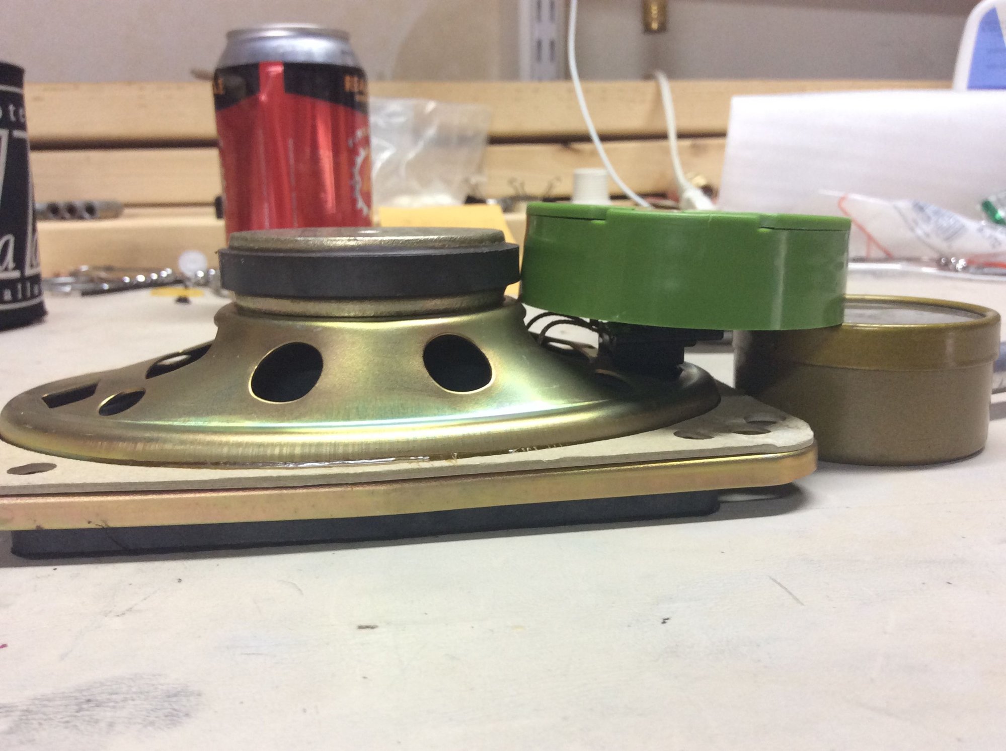

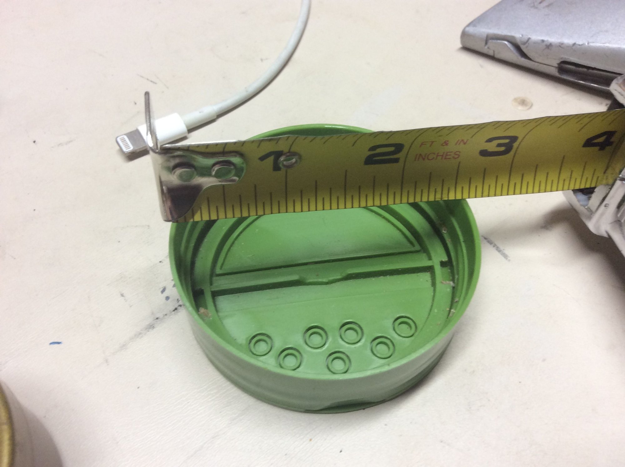

Just an FYI for those interested - Crutchfield cust service
JBL Concert Series 6421F and Infinity Reference REF-6432cfx 4x6 speakers for front dash of 1990 Firebird. I've heard reports some 4x6 will not fit. Firebirds have very tight space up by instrument cluster. Can you get me dimensions for these 2 speakers so I can see which one is smaller?
Thank you for reaching out to us. We are always updating and making our website's vehicle guide smarter and better every day. We have had research on your 1990 Firebird for several years now and I am confident our information is correct. However plate type 4x6 speakers and larger magnet speakers may have trouble fitting from what our database on my end reads out.
Infinity Reference REF-6432cfx 4x6, magnet = 2.7" in diameter. The frame dimensions are 4.53" width by 6.2" length.
JBL Concert Series 6421F 4x6, magnet = 2.8" in diameter for the magnet; the frame is 4.02" in width and 6.22" in length.
Kenwood KFC-4675C (known to fit) 4x6, magnet = 2.3" diameter
Not certain what they mean by frame......

I believe the frame is total width and length. Let me know your end results on speaker choice and fitment. Thanks.

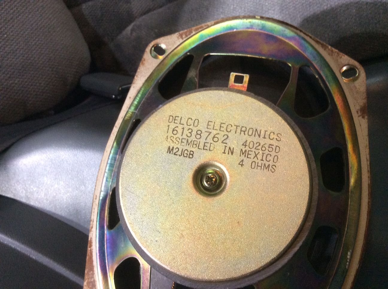

Will do. I have confirmed in 1990 4-ohm speakers were in back. I've read 10 ohm used up front, possibly to prevent cross-talk due to how the amplifiers were connected to them. Not exactly certain what that means. You would think the amps would be isolated.

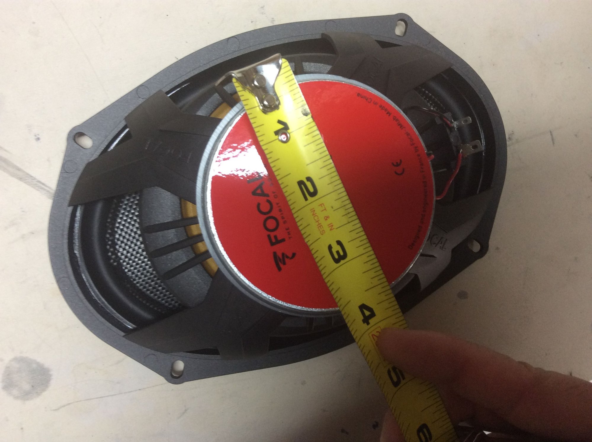

Also here are some Factory 6x9 speaker measurements:
Magnet : 3-7/8" diameter
Depth from bottom of speaker cage to bottom of magnet : 3"
Depth from top of speaker to bottom of magnet : 3-1/4"
The factory speaker sits pretty flush with sail panel, so 1/4" is about all you can have before its starts pushing on sail panel.
The depth from center of magnet to foam enclosure is somewhere around 4", but as you go toward roof line that gets to be 3" (didn't measure precisely, but now that I think about it, should have broke out my laser ruler)

John - took your advice and bought some 2-way co-axial 6x9 - 4 ohms to replace my factor 4-ohm rears.
I'm reading that factory 10 ohms are used up front. Well can't find 10 ohm, or even 8-ohm speakers. Do you recommend putting a wire-wound resistor in series so the AMPS are looking at 10 ohms to keep current limited to the speakers? I recall someone saying their front replacements were too loud, probably because the fronts are being driven with over twice the current due to the lower ohm speaker replacement.

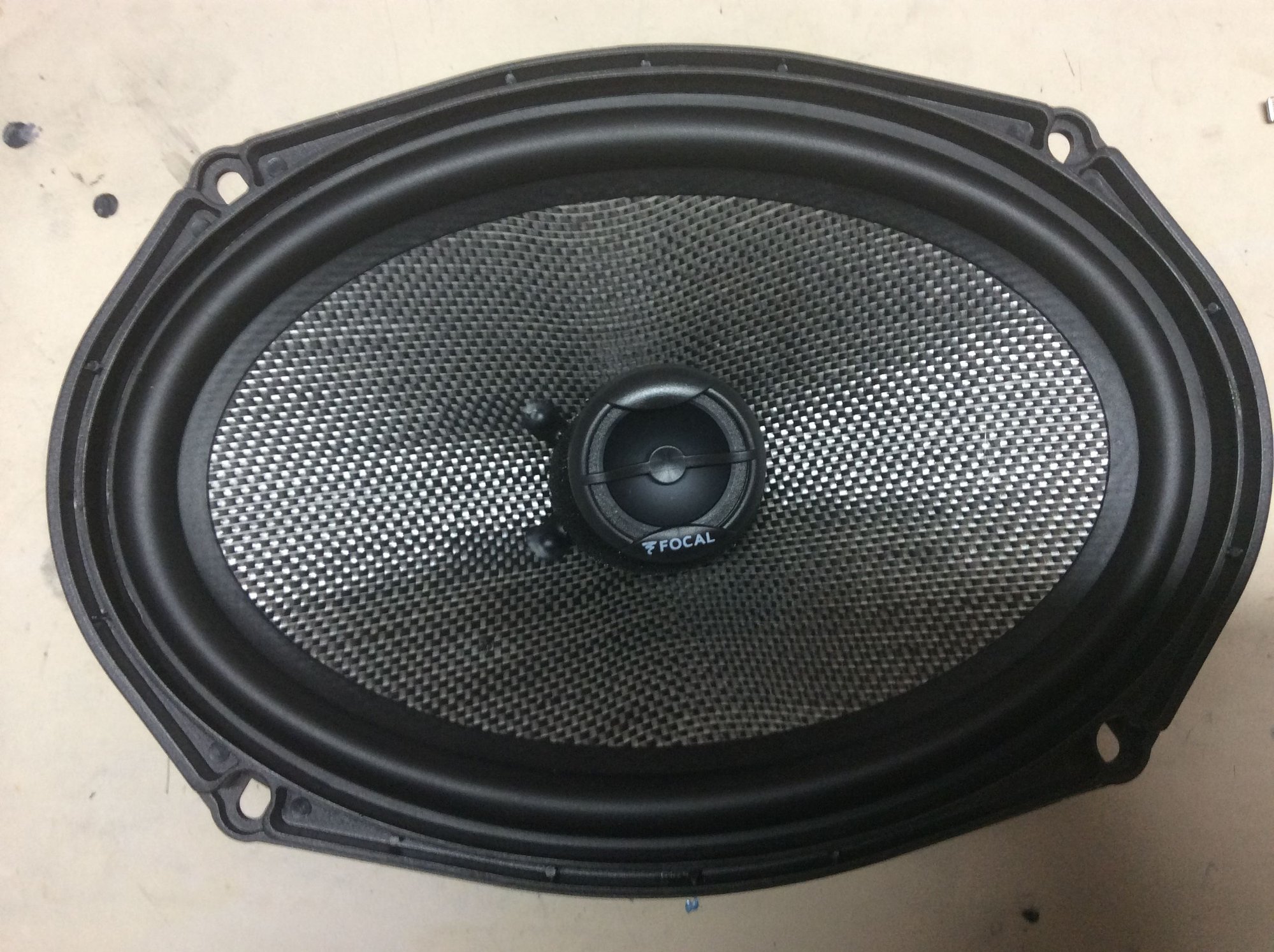

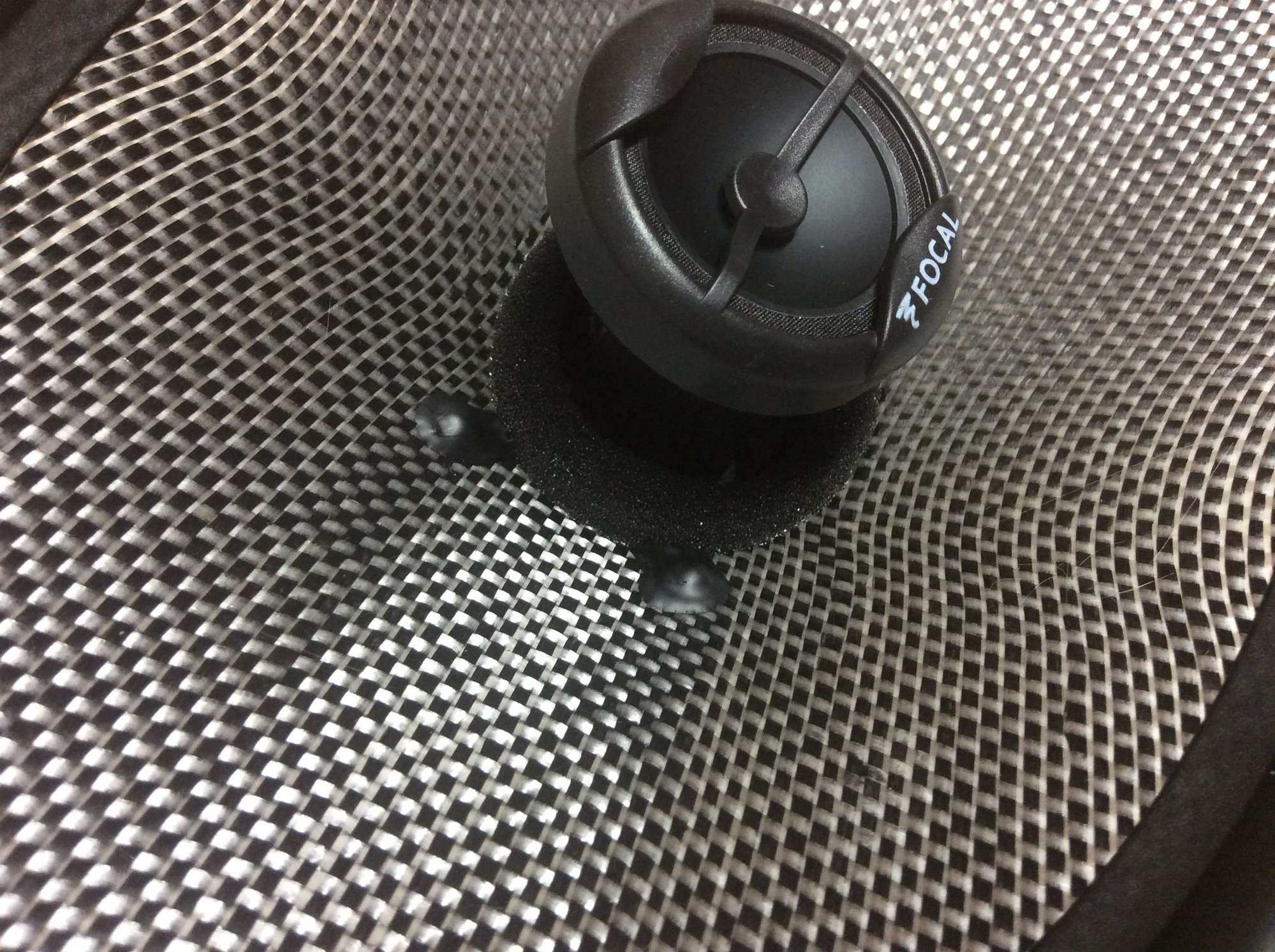

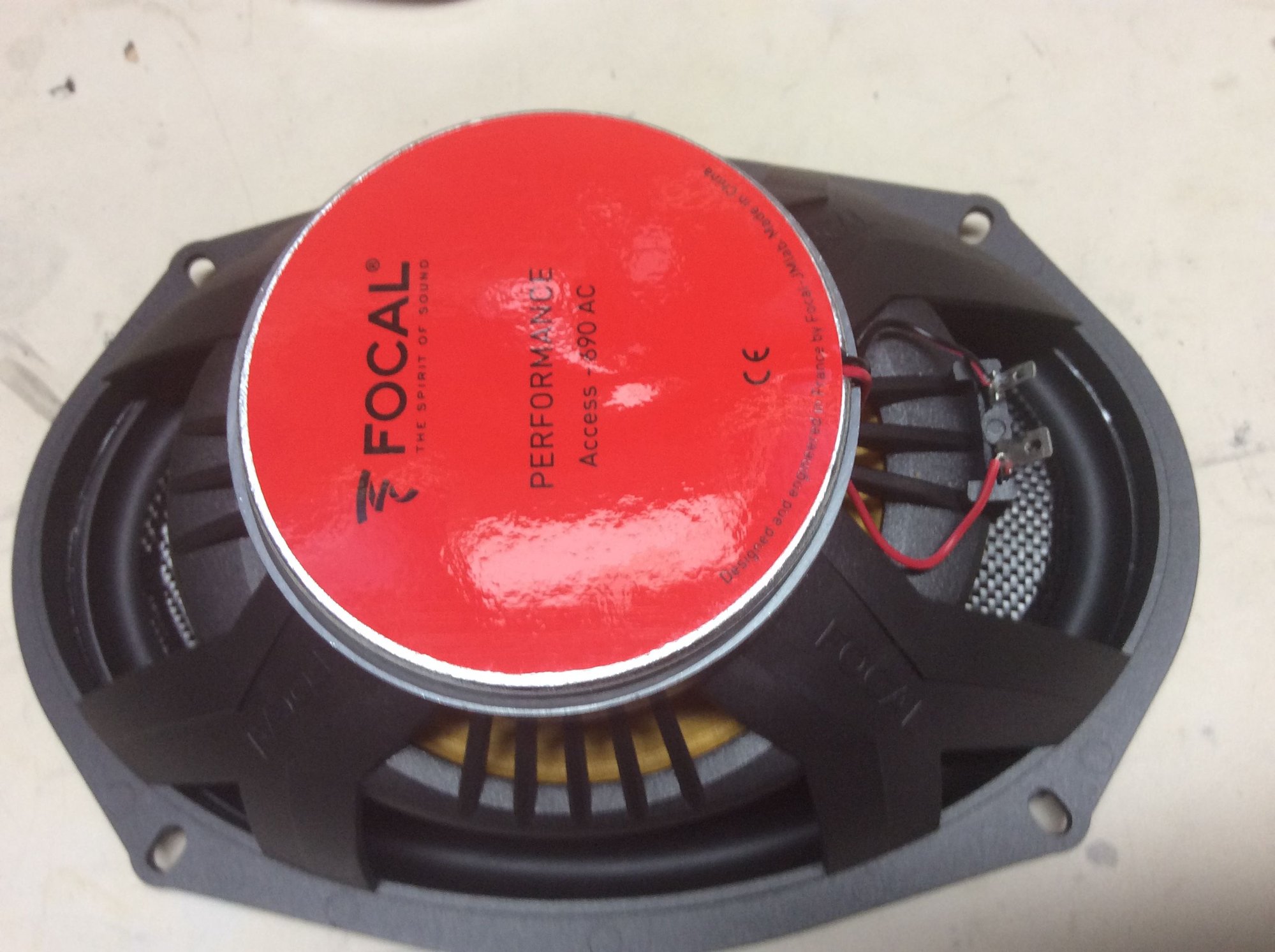

decided on these. they sound great and barely fit. the magnet is pushing on speaker surround foam stuff at the top. next up replacing front factory with new 10 ohm delco replacements made in china with same part number, the current factory speakers are plenty loud, but think they have some issues.
making sure holes line up
removed focal grill thing

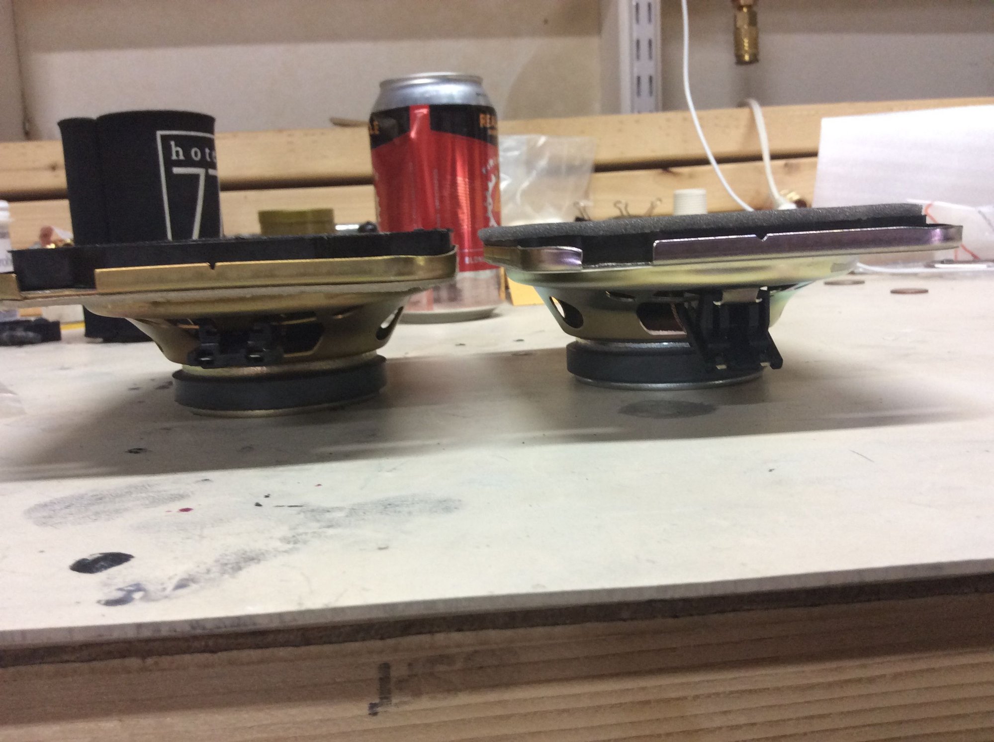

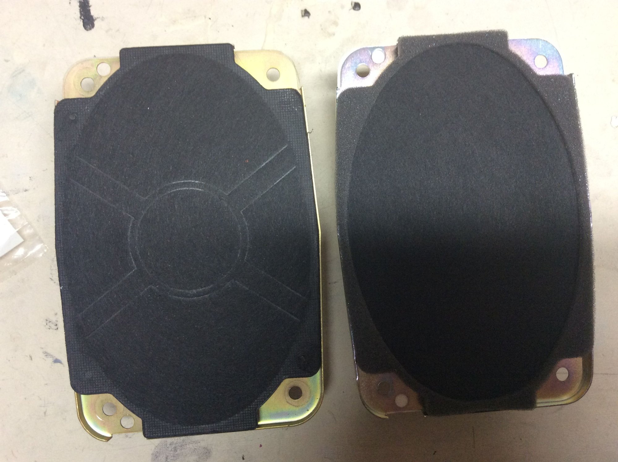

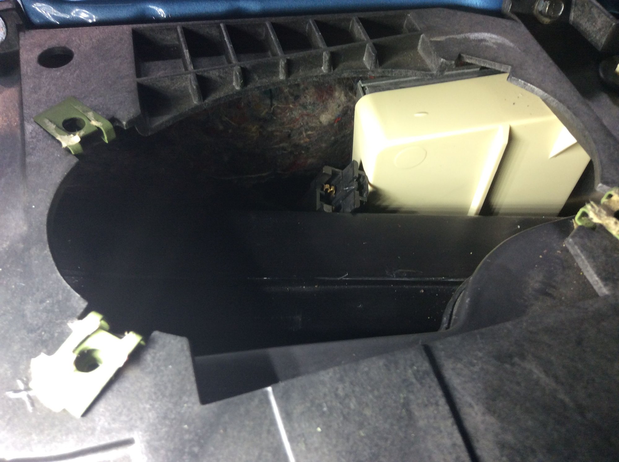

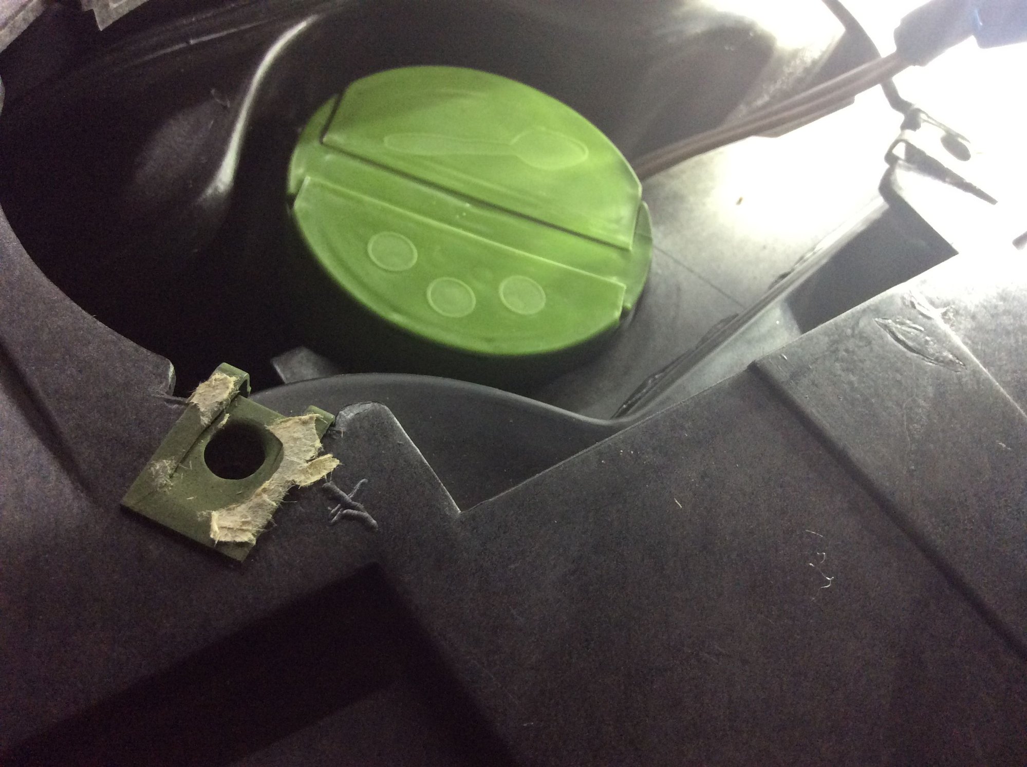

here go photos of factory part number replacement along with why driver side is tough to fit in firebird
j
i
factory on left
factory covered speaker wires in foam that is so old and crumbling
passenger side has lots of room
