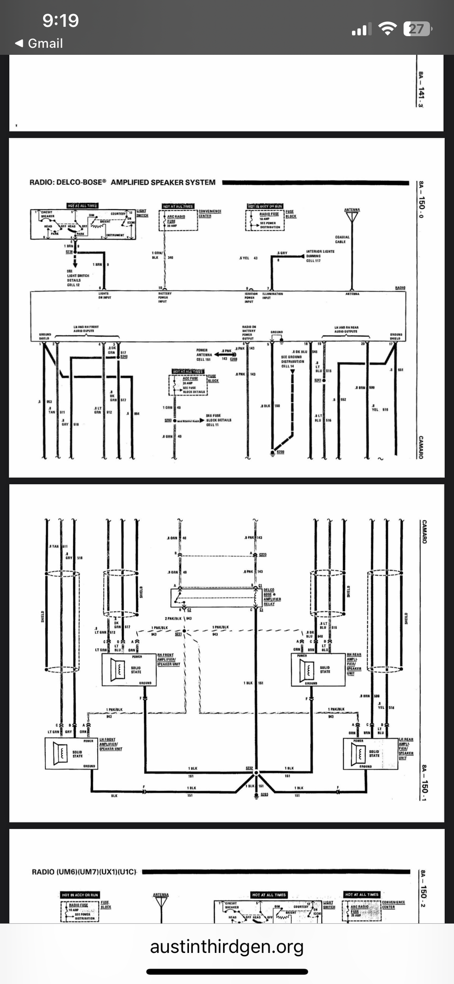

Looks like there were two different setups. One with an amplifier and one without. Assuming everything’s stock?
I would start by looking up your RPO codes in the center console to see what style of radio sound system you have. Depending on the type I would review the attached wiring diagrams and go from there.
