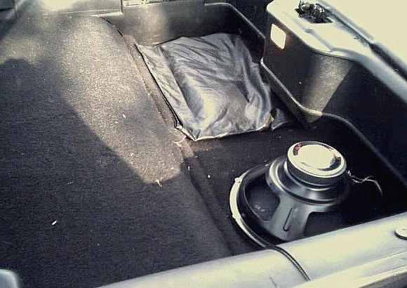

I got my two 12" MTX's mounted like that on a plate. Face to face. It's called isobaric. Mine sounds great. Look at my pic in reader's rides. All I did was add a piece like this to cover that little cave on the back wall, so that air couldn't get through.
i _____________
/____________/
\_______/
I also added a strip on top, at the front so that the board would be firmly held down onto the sides of the well. Just cut it so it looks like this from the side. That way it flows the edge into the carpet. Then screw it to the car, not using any longer that 1 1/4" screws, if your using 3/4" board.
|\45 deg. angle
|_|
EDIT: Here's a link to the pic. https://www.thirdgen.org/rides/rideimages/Sub.jpg Hope this helps.

well thats not what I was thinking of but it looks good. I was thinking more of a bass tube(except square)...with the subs at either end. I was just wondering where I should mount the 2. Or more on how much room to leave between the subs...
