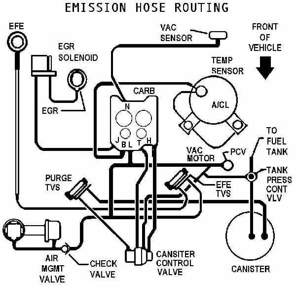

I have ripped out all the hoses and components so does anyone have a picture of where the hose goes to from the EGR. I just assumed I would not put any of that stuff back on..I'm glad I saved the O2 sensor..

If you are ditching the emissions, including the computer and O2 sensor in the exhaust you can't use that carb. The ECM is REQUIRED in order to adjust the A/F ratio with that carb. Unless you are keeping the ECM, the various engine sensors, the O2 sensor in the exhaust and the matching computer controlled HEI distributor it won't run right.
Exactly what are you ditching off the motor? Just getting rid of the EGR valve could cause minor problems. Going with headers that can't take an O2 sensor you're definitely going to have problems.
Once you take just one minor part away from the ECM you're better off ditching both the computer controlled carb and the computer controlled distributor and going with older mechanical-only systems if you expect any kind of performance and economy out of the motor.
Damon, I have pulled out the original engine and trans. I just got back, tonight; a 350 bored .030 over with 9.7:1 compression pistons. Beside the emissions (smog stuff) I was going to eliminate the EGR valve by purchasing an intake w/o the EGR. I was going to have the O2 sensor put into a set of Headman headers I have for the car. And I was planning on still using the Q-Jet and distributor that came on the car. The car is the digital dash and I wanted to keep the tach in working condition, so I figured I need to keep the carb and dist.

Will it run? Yes. Will it run it's best? Probably not. Will it light the "check engine" light? Possibly.
First the performance: Wide open throttle, no problem at all. ECM isn't looking at the O2 or any other piece of emissions equipment at that point so you're good to go.
Drivability: Gets into a "gray area." The ECM bumps up the spark advance at part throttle, assuming the EGR valve is present and functioning. EGR gasses help keep part throttle combustion temps low for better emissions. When the EGR valve is open the ECM can advance the spark quite a bit farther without detonation. Runnign without the EGR valve it'll still be putting in the added spark advance but there will be no EGR gasses there to complement it. Possible result- part throttle detonation. You're gonna have to see how your particular combo reacts and judge if this is a problem or not.
Check engine light: LOTSA little gremlins here. You MUST have the EGR vacuum solenoid still plugged into the computer (2 or 3-wire connector electronic solenoid in the middle of the vacuum line system between the carb and the EGR valve). If it doesn't see it plugged in it'll freak and immediately light the check engine light.
If it sees no vacuum at that sensor it'll freak and EVENTUALLY light the check engine light.
Even if you leave it all in place and just plug the vacuum line where it would have plugged into the stock EGR valve (which is no longer present, obviously) it might STILL light the check engine light. The ECM has no way of DIRECTLY knowing if the EGR valve is functioning or not (or even if it's actually there). But it can INFER it's functioning from looking at other sensors under certain conditions. I don't know exactly how it does this but.............. if you get a "check engine" light when cruising at a constant throttle on the highway after 5 minutes of so, this is almost certainly what is causing it. Some people can ditch the EGR and never have a problem, while others get the dreaded check engine light. I'm not sure of the fine details on this issue, but you should be aware of it's existance.
