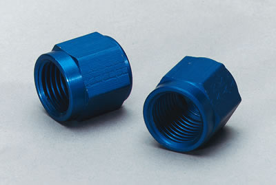

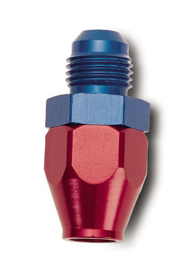

As for the fittings, I'm assuming you are reffering to the hardline adapters like those offered by Russel. Either the -AN style fittings (like those used with braided stainless line) or the tube nuts and sleeves. Are those the ones you were talking about?
Those fittings?
Old Jul 16, 2004 | 11:15 PM
2 dope's Avatar
Joined: May 2003
Posts: 616
From: Windsor,Ontario, Canada
Car: 1985 Camaro Z 28
Engine: 305 LG4
yes, I can use those to run into my carb, i had to break the old fuel line off but managed to save the actual piece that threads into the carb, I suppose just flaring the end of the broken fuel line and placing the nuts on it would work as well.

Would you want the hard line or the braided stainless line? The fittings I posted above are for the hardline, 3/8" to be specific. After you determine hard or braided line, is what you should do is find the proper size fitting for the fuel pump and the carb inlet and just run the line from one to the other with an inline fuel filter somewhere. That would be the easiest. No flaring of the factory line or whatever.
