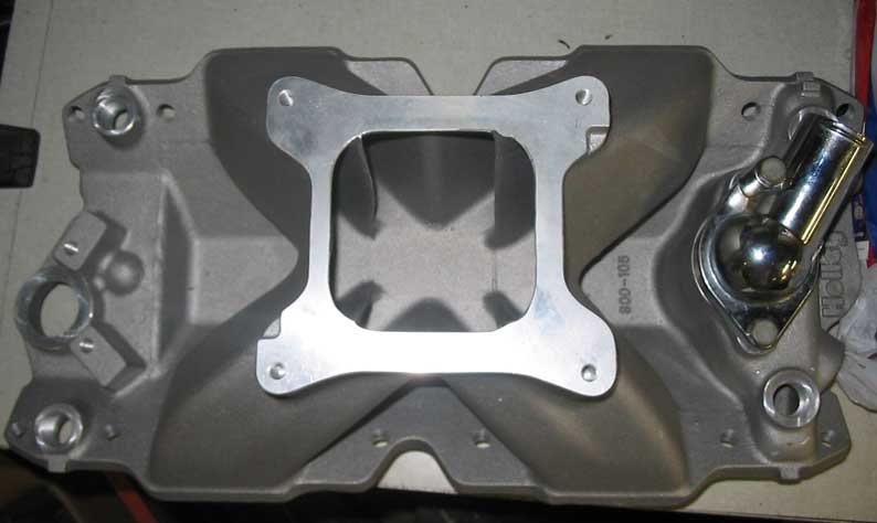

Fit with stock Hood?
I am wondering if a Weiand Team G intake #7530 and a Barry Grant Speed Demon will Fit under a stock hood. I will be using a 2" drop base air cleaner with a 4" K&N
or do I need to buy a cowl. I wanted to put off buying a Hood for about another year.
Old Nov 25, 2004 | 05:44 AM
MTPFI-MAF's Avatar
Joined: Dec 2003
Posts: 623
From: Point Marion PA.
Car: 1982 CAMARO;
Engine: 1985 LB9;
Transmission: T-5/
Well after a little more research I think it might Fit.
Holley stealth Ram is 10 1/4 tall
the weiand team G is 4.56"
The I need the Air filter to clear the 4.75" of the Vent tubes
so If I take the measurement the air filter base to the Bottom of the base plate which is 3 1/4"and deduct the 2" for the drop base air cleaner that would put the bottom of the air cleaner at 1 1/4" from the base plate.
Now add 4" for the filter that is 5 1/4" add that to the Height of the Intake and I get like 9.81" just over 9 3/4 so I should still have room for a lid with recessed Nut.
Any one agree or disagree

Old Nov 26, 2004 | 08:59 PM
koll's Avatar
Joined: Jul 2004
Posts: 121
From: Rumson, NJ
Car: 1991 Pontiac T/A Vert
That looks like my intake
The general consensus was that with the stock hood it would work.
