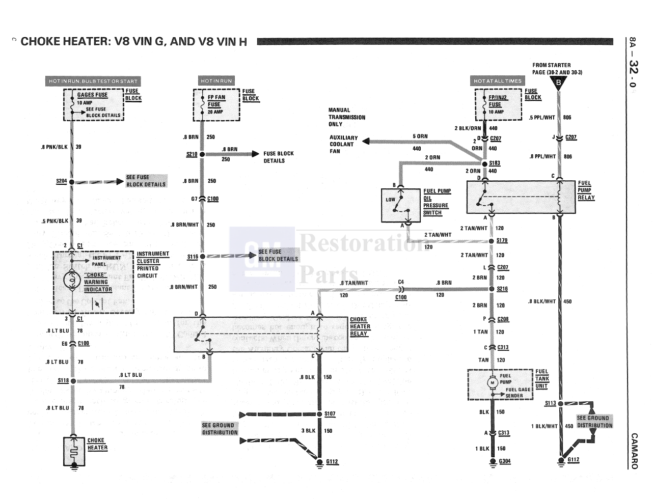

You should have 12 volts with the eng off & key turn to on
No, you should not.
That's the purpose of the RELAY that's making the buzzing noise. If your car has 12V with the key on and the engine not running, the wiring has been hacked on.

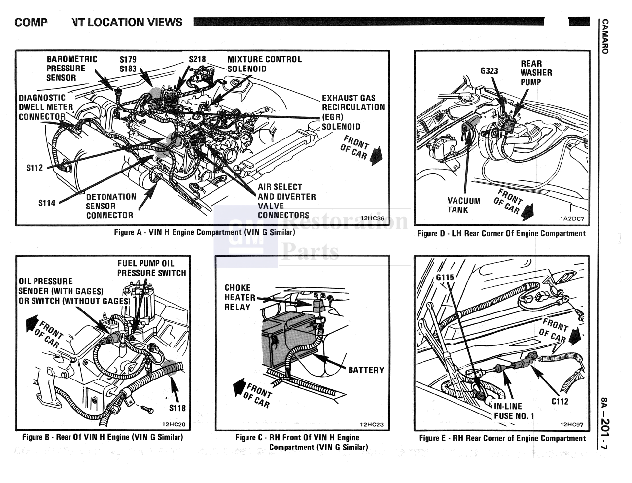

Here's the schematic for the charging circuit, out of the GM service manual. Obsever the relay, which is in parallel with the "Choke" light; and observe that the choke will only receive power when the relay coil DOES NOT receive power, which is also when the "Choke" light is not lit. Note that one side of the light and relay coil are fed 12V from the switch, and if the alt is not working, current can flow from the switch through the light and relay coil, through the diode trio in the alt, to ground. When the alt is working, 12V is also applied to the coil & bulb by the diode trio, and since current doesn't flow between 2 points of equal voltage, the light goes out and the relay drops out, applying juice to the choke coil. You will however measure 12V at the choke wire with a voltmeter, but IF AND ONLY IF the wire is disconnected; because you'll be seeing battery through the light bulb. Hook the wire up, and since the bulb only allows a VERY SMALL amount of current through, nowhere near enough to actually heat the choke, the voltage applied to the choke coil will be VERY VERY LOW in a normally operating car, and the choke will do nothing.
{edit}hmmm...... looks like I should have shrunk that....

Here's a better copy of the schematic, out of a different year manual. And of course sized to fit the screen better.

Sofa- you're obviously better with electrical diagrams that I am, so if you don't mind, I've got a question....
On the relay am I reading it correctly that it's default position is to send power to the choke heater (i.e. if both poles have equal voltage the relay is not engergized, but that voltage is sent to the choke heater)?
I can't for the life of me figure out how that circuit could ever do it's job to indicate if the choke itself was bad or physically unplugged. I mean, it seems to be completely deaf to what's going on at the end of the choke heater wire, no? Plenty sensitive to a bad alternator, but how the heck could it know if there was a problem with the choke and light that same bulb?
Old Nov 13, 2006 | 11:23 AM
Posts: 28,014
Likes: 2,492
You're exactly right Damon. The circuit has no way to "know" whether the choke is unplugged or not (which is why uplugging the choke doesn't light the light, as I debunked the myth above); all that the light's connection with the choke is, is that if the alt isn't working and the choke will therefore never pull off, then the light will show that.
Again, strictly an emissions **** kind of thing, as far as I can see. Evidently they got their concerns elevated in importance to the point where they were able to override common sense. It seems beyond merely stupid to me, to mislabel one of the most important "danger" warning lights like that, to where there's no way that an uneducated operator of the car would actually know what to do and would do the right thing based on what it says; but they didn't ask me before they did it, so I guess now we're just stuck with it.
Think of the relay as being like the light, in terms of its "default" position. Light on = unhappy = relay operated = cuts off power to the choke; light off = happy = relay released = allows power to the choke.

You know, I'm going to post up the equivalent circuit from a similar vintage computer controlled carb Buick Regal I worked on several years ago- if I can find the diagram. It's surprising how different it is, and how much simpler, considering it's supposed to accomplish basically the same thing. And, by the way, it actually IS sensitive to whether the choke is hooked up or not.
I will look for it tonight.
Does the choke circuit on a 3rd gen go through an oil pressure switch somewhere? I seem to recall it does- I KNOW it does on the Buick.
Now where is that damned diagram????..............
No, the thirdgen uses the alternator wire to tell if the car is running.

Hopefully this is still some help on this subject. I have an 85 camero 305, with the quad-a-junk. About a week ago my Choke light came on as well, I have checked and the choke is working perfect. I took the above suggestion and replaced the alt (key board is getting greasy as I type here) but the choke light is still on. What should I look at next. Oh BTY my seat bealt light is on also it is very dim but on, this came on during my drive about 10 minutes after the choke light came on. The 3rd gen expert at the part store is pretty sure that the choke light is wired thru the oil pressure switch also. Any and all help will be greatly appreicated.
Old Nov 28, 2006 | 11:01 PM
trumps2000's Avatar
Joined: Jul 2005
Posts: 459
From: Bloomingdale, NJ
Car: 1985 Z28
Transmission: T-5 5 Spd
Axle/Gears: Built 10bolt w/3.73s
Check the C/H Fan fuse, my was blown and caused this problem as well. If you ever want to know anything electrical about the 85s or 86s look under the electrical tech articles from the thirdgen homepage, tons of schematics.

Thanks! the problem is fixed! It wasnt my C/H fuse but my gauges fuse.
