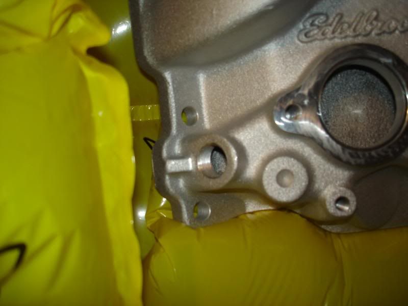

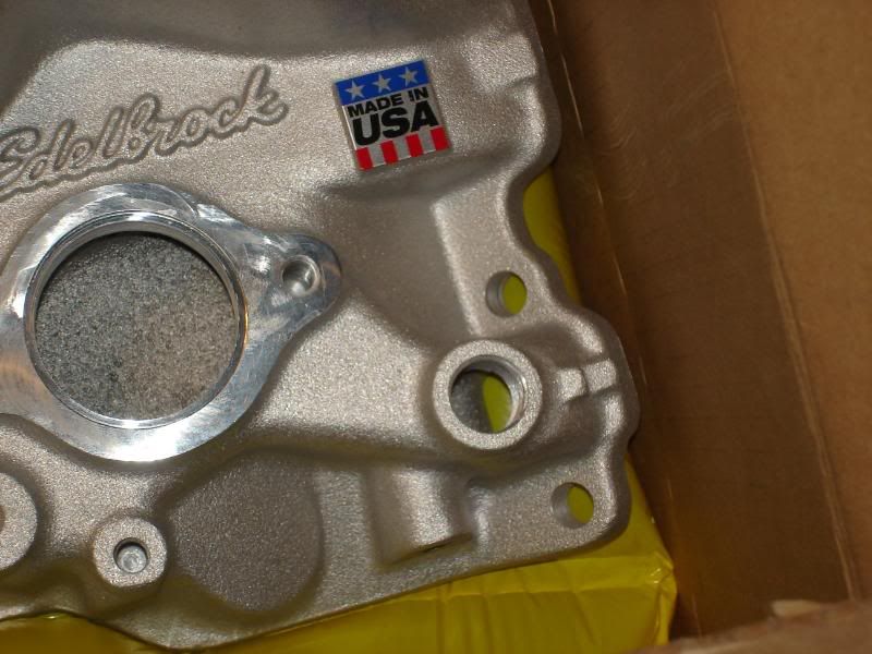

need help with my edelbrock perfromer intake!!
just bought a new edelbrock performer intake part number 2104 for my 87 sb chevy engine and theres two big holes off to the side os the thermostat that arent on my stock intake if ne one knows what goes into each of these holes plz tell me and no there not the holes for the screws
these are the photos of the two holes

They're for thermostatic vacuum switches used in the late '70s. Plug them.
what can i plug them with

brass pipe plugs. Available at any hardware store.

Mr Gasket does some nice chrome Hex plugs that make it look better then the hardware store stuff. I've just used them on exactly the same manifold. Comes in a set of plugs, I used two of them for these holes and another for what would be the temp sender.

Jegs has anodized pipe plugs in a variety of sizes, colors etc... So does Summit!

So, where does the heater core hose fit?

put it in the left hole and a plug in the right one
