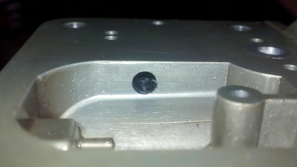

OK, so you have a holley base plate and upgraded to a Proform main body, if you look at the main body upside down you will notice that there is no spark port at all, the gasket has the hole for it but there is no hole in the main body itself. This is where it gets a bit more complicated. What you have to do.
1. drill a hole in the side of the main body INTO the power valve vacuum chamber, I used a 3/16 drill bit, remember to use oil when drilling! This will make your life so much easier.
Clean out the hole, and the surrounding areas, I used a compressor to blow all the aluminum out.
Now you need to plug the vacuum hole from the base plate all together, cause this vacuum hole will still be giving it vacuum. I used a two part epoxy (JB Weld)
Now you need to make a vacuum line that comes into the chamber, I used some spare 3/16 nitrous line I had laying around, you can also use brake line or what have you.
Again, I used a two part epoxy, rolled it around the shaft of the vacuum line and pressed it into the hole I drilled. It fits so snug that it will keep all the epoxy on the outside of the carb main body making an air tight seal.
