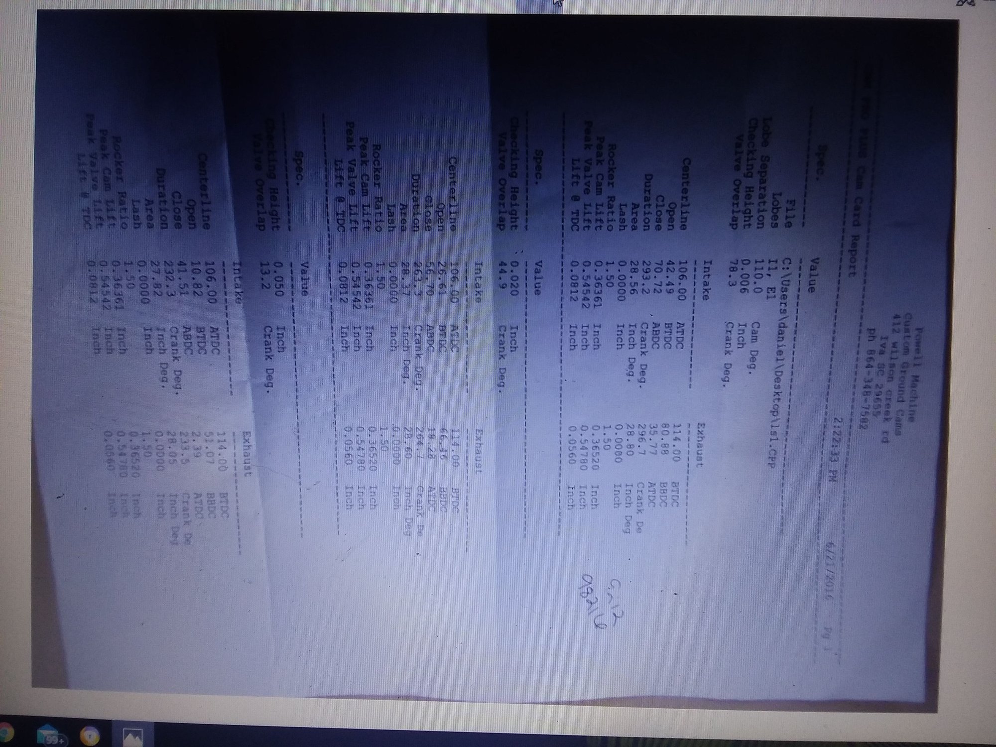

Yes, that's what I did, started all over. Set timing to 10deg, all in 36ish. have the front mixture screws out .75 and rear out 1. Achieved 10" of vacuum, runs much better, but still smells rich.
waiting for it to cool so I can take off and look at transition slot. See where it's at.
is 10" ok for a 232/233 106/114cl .545/.547 @.050. Seems low to me.. it will idle at 600rpm but seems to lopey. Nice smooth idle at 700.. fuel pressure gauge is nice and smooth now also. Before it bounced like crazy from 5.5 to 10. Now it's right at 6.

I would think it needs more base timing. That'll wake up the idle. But obviously you'll have to take some out of the mechanical advance. If you have an HEI, you're kind of screwed. Limiting the timing on those takes some fab work. My MSD distributor has interchangeable timing bushings. I run a minimum of 16 initial. It's more like 28-30 because I have my vacuum advance connected to full vacuum. That can be a exercise in tuning in and of itself though.
Do you have full specs for your cam? Advertised duration specifically? I'm running COMP's XR288HR with 236/242, 288/294, 110 LSA. That gives 71 degrees of overlap. With a worn out engine I can muster 10" of idle vacuum at 750-800 RPM. That's with a healthy base timing though.

Heres the cam specs.

I am running a hei now but have a adjustable can. I have a msd 6al programmable, but have yet to install it. Believe I can hook that afr to it as well and log data.
I would be interested to know if the MSD programmable ignition is strictly RPM based or is there a MAP input as well. If you have MAP then you won't have to consider the vacuum can on the distributor. I've adapted a MAP sensor into my carbed 350 and data log with that via an old Innovate interface although I still have to use the vacuum can for tuning.
That's a sizable cam! 293/296, 110LSA. I work out 74 degrees of overlap. Your cam card says 78. Compared to my 71 degrees your 10" of idle vacuum is doing well I'd say. These big cammed SBC's will eat up a lot of idle advance. Just pay attention to spark knock.

That duration is at .006 checking height. If you go down to .050 check height its 232 or whatever. Isnt that how most cam cards are given? (.050)
Yes. Cam cards will list all of the specs that are on your cam sheet. Advertised/.006" duration as well as .050" numbers. Also Lobe Separation Angle and lobe centre lines.
Some builders want the .050" numbers. Others use the advertised numbers. I tend to use both.
