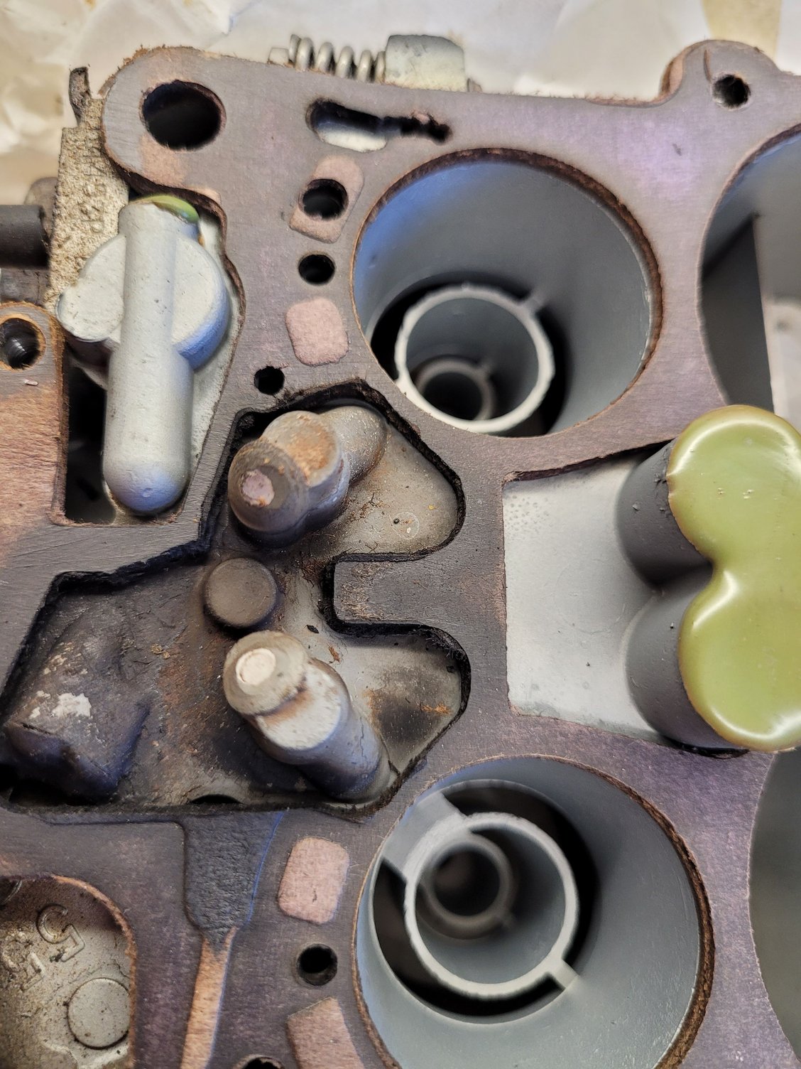

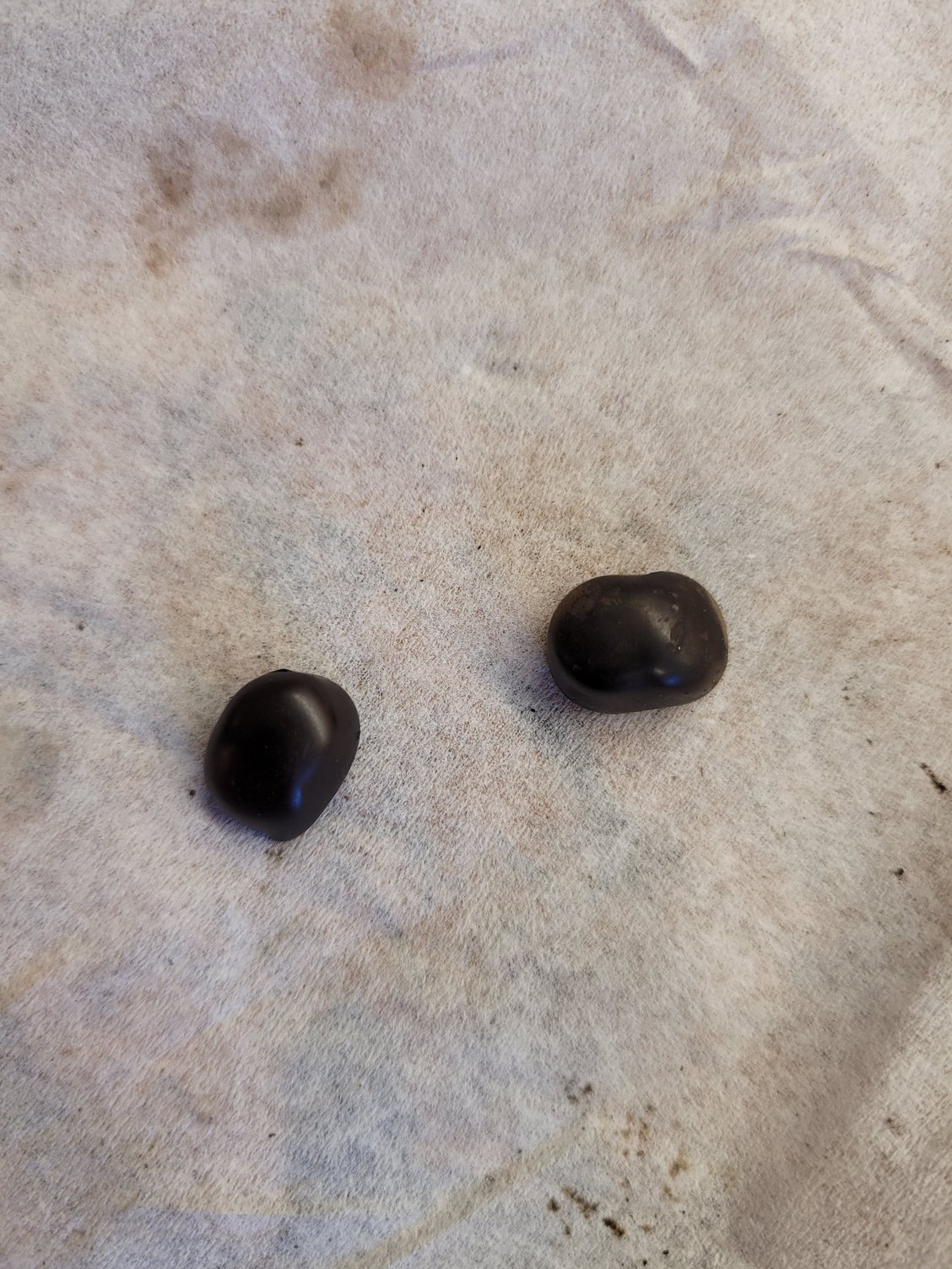

Ended up buying an overhaul kit to the carburettor since the smell seems to come from this.
After dismantling the carburettor I found two loose plastic cups.
What is the function of these ?
Old Mar 12, 2022 | 10:14 AM
aliceempire's Avatar
iTrader: (14)
Joined: Nov 2008
Posts: 2,097
Likes: 177
From: Milwaukee
Transmission: T-5, TH350, T-5
Re: Fuel leak....
A poor attempt at fixing leaking well plugs. They expoxied the plugs on the outside of them and eventually they fell off from fuel and heat cycles. You can see the yellow goo epoxy on the secondary well plugs. While you have it apart, fix it correctly. It sounds more complicated than it is and there are decent tutorials online. Basically you drill, put a screw in and pull out the old aluminum plugs. Tap the holes and thread in set screws with correct epoxy on the threads. Marine Tex makes a compound that the heat cycles and fuel doesn't degrade like the others.

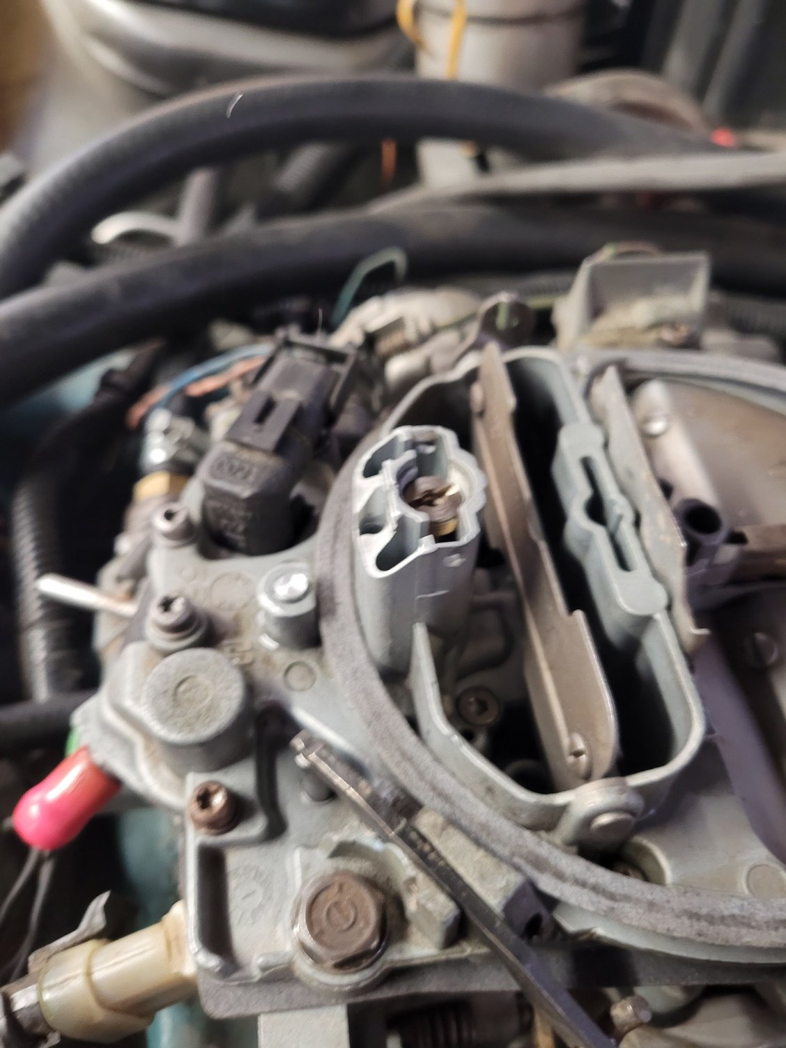

I managed to stop the leak aound the accelerator pump and the tps stem by replacing the seals, but now it leaks through the vent hole or inspection hole on top of the carburettor.
It comes out aound the shiny aluminium cap in picture.
I can only assume that it is the float level that is too high.?
