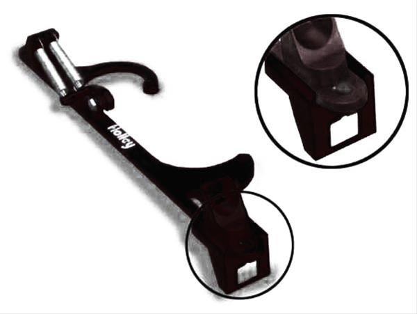

I used this bracket from Holley.
Holley 700R4 Transmission Cable Bracket

In addition to the above, which mounts the TV cable assembly to carb, you'll also likely need the cable correction bracket. This mounts directly to the throttle shaft (where the throttle cable attaches) and provides the proper rotational geometry for correct TV operation.
The first bracket listed mounts the jacketed portion of the cable. The second bracket listed mounts the inner cable itself to the throttle.
https://www.summitracing.com/parts/hly-20-121
