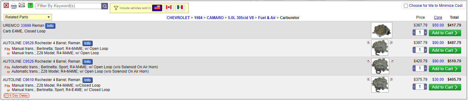

The factory Q jet is a 750CFM. You can either rebuild or buy a rebuilt one. Rock auto is one option but you can look around. There is no good reason to swap to another carb on a stock or near stock motor
