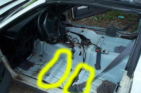

Would it be possible to grind down .5 of an inch off of the floor pan "bars that support the seats?
The reason I aks is that I am 6'2" and my line of site is about 60% of the top of the windshield. IE it is very difficult to drive with the top up.
I would like to grind it down .5 of an inch, refill and than build a small steel brace that also moves the posts back about 1.5". So lower and move back. I just didn't know if these had any structural implications. I could always reinforce, but that .5" will give me enough room to comfortably drive with the top up.
Any ideas? Could I go a full inch? I know there is a curve to the floorpan, but I measured it out and the seat will still go back and forward all the way if I lower it. Plus the seat is always all theway back anyway because of my height.

My problem is I am taller in my torso, not my legs as far as that goes, but your seats, if you removed your carpet, should be on supports. I will try to find the pic of what I mean that I can post that. I am going with SFC's, and I planned on welding a nice support for it as well.
Edit:
Here's the pic
Sorry, never have attached an image before... For some reason it wont bring up the image, just the link, but if you click the link you will see what I mean
Edit:
Here's the pic

ahhhhh... gotcha.
if you did do it, id have subframe connectors on JIC anyway......
if it really worried you, you could always add bracing even if all it did is make you feel better about it.
if you dont mind just dropping the seats and not moving them back, you could just make 2 cuts straight down on each side of the stud, (for each stud) and take out the metal, then have the seat sit on the floorpan, so that the seat rail mounting tabs are on the floor.... just tac weld the stud thru the floor.....

Well, I am moving them back about 1.5" as well. Just when I was measuring and things getting ready to make some kind of brace that could be welded in I noticed that it looks like it was just welded on and not really part of the structure, but I wanted to make sure. Last thing I want to do is go cut my car in half
So I think I should be able to drop, fill, move back and weld. I am getting a set of Alston SFC's. So that shouldn't be a problem. Thanks for the info I will make sure to take pictures as I go along.
