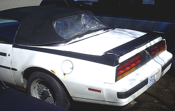

...I notice you mention Goof Off? is it. I know of a Goo B Gone type product, but instructions state a heat gun used to remove and/or loosen orig adhesive.
I have the drivers side stripping half on/half off (stuck in the rail of the metal guide but it comes out on it's own, towards the bottom. I took a few shots of the inside top frame people have seen here too
BILL
Attached Thumbnails The '8-hour' Install-c-windows-desktop-car
