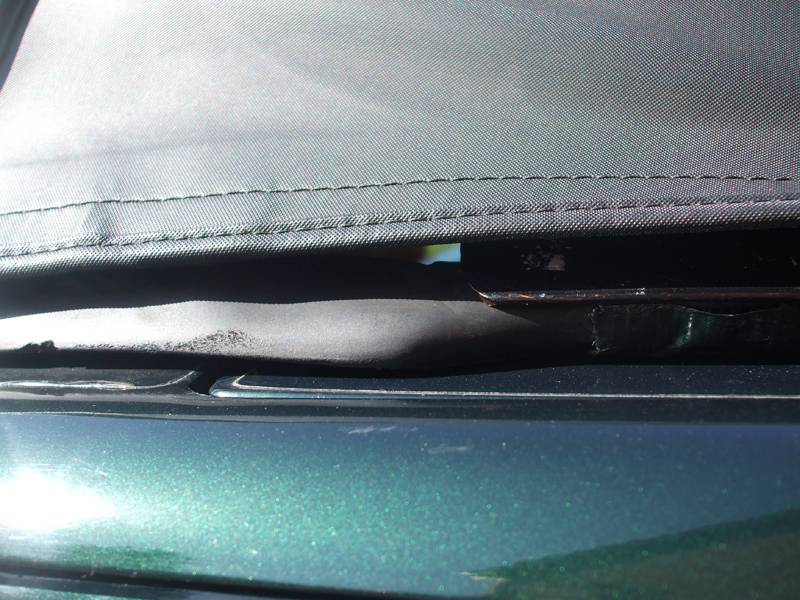

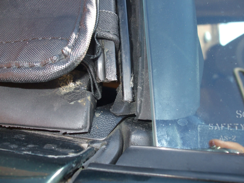

Hi guys, I have a new toy here in England and I have attached some photo's of my top that I'm sure needs some serious adjustments. What is not clear in the first photo is that the pin is too far back from its locating hole, the rest you can see for yourself and please note that the second picture showing the gap is on both sides of the vehicle. I have read as many threads on here as possible concerning adjustments but I still need some advise, especially as my chances of seeing another one over here are unlikely. Thanks.

if im not mistaken the front pins must drop in first then the resr pin thats how top is tightened when in up position......
as far as the sides looks like you may need a new top.....
try to "move/slide " top material on frame a small amount..see if it helps for now

ok just try carfully to move top on frame a little bit only.......
also when closing it aline front pins before lowering rear bow.....
also check to see that all drains are not cloged on on each side by seat belt assy.

Thank you, I assume the pin alignment is done by the upstop, but do you think the gaps down the sides are because the top is too small?

If possible can someone please post a picture/diagram of the seals in the area of the rear quarter to rear of side window. I think all the seals are there, the bow 5 seal, door jamb seal and side window seals, but between the bow where the side window seal is attached and the end of the bow 5 seal there is a gap. Reference the second picture above to see what I mean.
