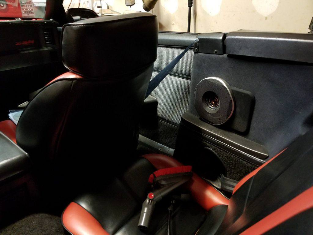

Best spot for magnet clearance is up toward the door, so I used the Infinity template they provide and marked the panel to cut full clearance to top mount the speaker, as far forward as I could without the magnet hitting the lower B pillar. I bridged the gap where the 6X9 size hole was with a piece of aluminum channel.

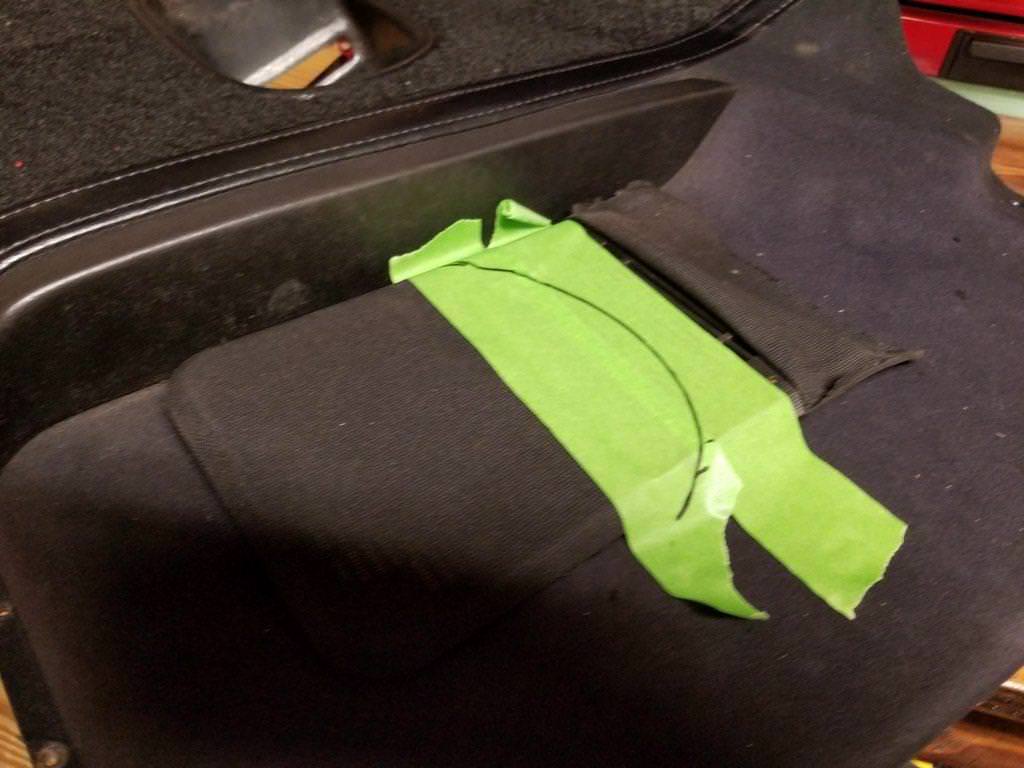

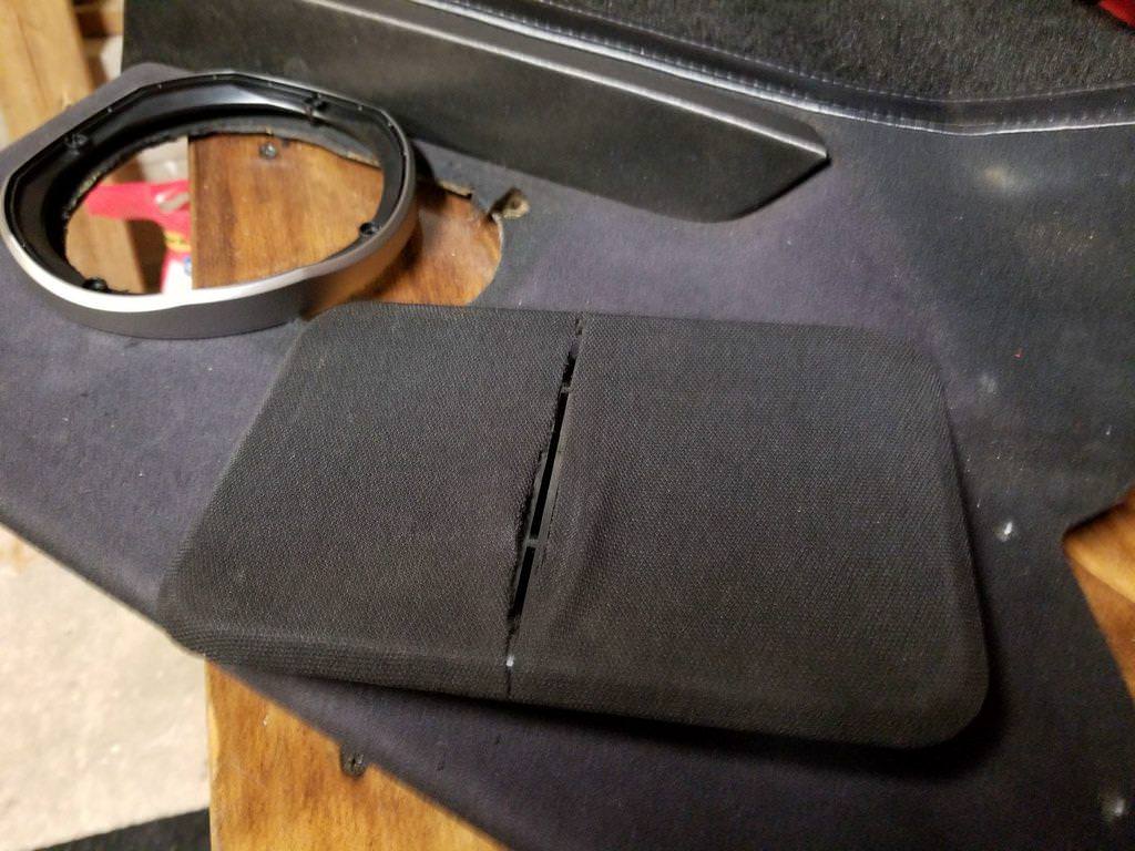

Here was the most risky part. I decided to cover the rest of the gap by trimming the grilles to mount up against the Inifinity grille. So I sliced down the middle of the fabric on the grille, then peeled it back, marked it with the outline of the Infinity grille, then cut it with a dremel and pulled the fabric back over the trimmed piece. Was worried about this not working and ruining the speaker grilles for nothing, but it worked great, and I was able to do both sides with one grille so I still have one good one left.

installed in the car. The reference speakers in all 4 corners sound great, and I'm very happy with the appearance of the factory grille notched out to fit up against the new one.

I hear you, I know these panels are hard to find. The panels were already cut up, so in my mind the damage was done, they weren't original any more anyway, and would need glass work / filler panels to restore. I made a very minimal additional cut to flush mount the 6.5, which I wanted to do.
The grilles? Yeah originals might be hard to find. They're just 6x9 rectangles with black speaker cloth fabric over them. If I ever need them again Im sure I can find or make something. And I only hacked up one grille to cover both sides

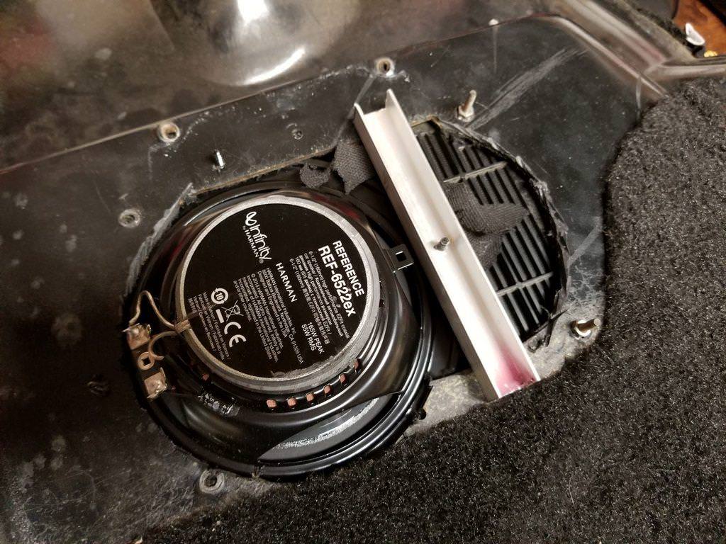

The reason most rear speakers will not fit in ASC convertibles FBody is because of a bar they welded in for structural support, only thing I've came up with is cutting a hole in that bar to fit speaker...

Yeah, There is a brace that runs at a 45 degree angle from the door jamb to the upper part of the rear quarter. No, I was not about to cut that, or anything structural, to fit a speaker.....
There is one particular spot where that brace makes a triangle with the B pillar and another horizontal panel, that triangle shaped hole is the only place you can hope to fit any kind of magnet. These speakers are just about centered over that triangle, just a little more forward (toward the door) than exactly centered. I should have taken some pics of that with the panels off, but I am sure there are pics of that here somewhere on this site.

I don't think I took a picture of what I did and I have no idea where in my build thread I put it if at all but that cross bar support was in my way of using virtually any 6" round speaker so I cut it and welded in some angle iron to reinforce the area where I removed metal. I thought it was strange that I only had to that on the passenger side. Tells me there is quite a bit of build variance in these convertibles....

Exactly you can cut it and reinforce it once you have speaker placed. ASC didn't care about speaker clearance when building these cars they were kinda hodge podged together, a lot of that has to do what GM paid them to do the convertible project of FBODIES…not much if you know GM...
