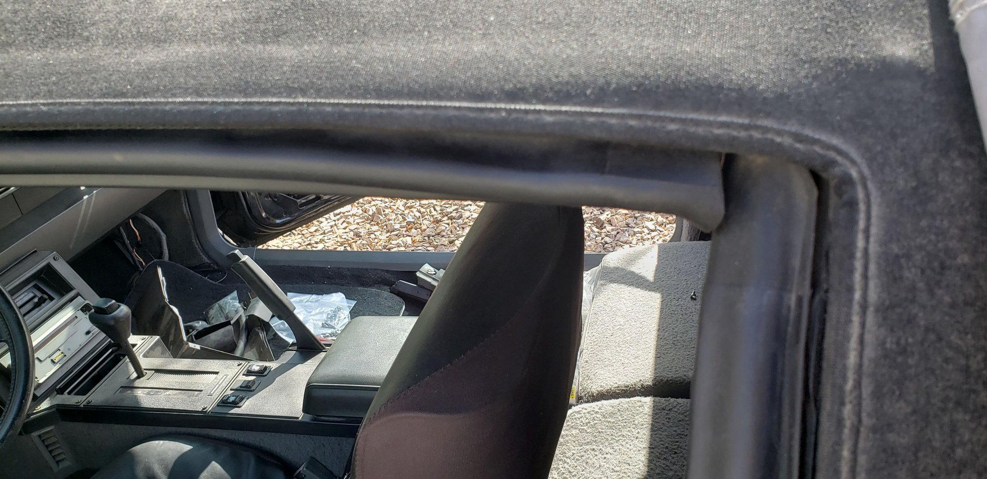

man i'm hating this 3rd gen camaro convertible top weatherstripping...
**** will not butt up or line up for nothing, 3rd set of seals, 3rd different manufacturer idk wtf the deal is and why nothing lines up. Top's dirty but new, seals are new have not glued anything yet cause nothing lines up in the front. Car is always garaged or covered. Driver side top roof rail looks like it's cut at wrong angle and too short.
Idk wtf kind of voodo ASC did when they made, installed these tops for gm back in the day but i can't find seals that fit right.

as i currently understand it there are At least 3 different style top frames for third gens:
87-88 (slider Tonneau release 87-88 front bow and window)
89 (handle Tonneau release 89 front bow and window)
90-92 (handle Tonneau release 90-92 front bow and window)
I have seen no pictures of the differences between these 3 thus far...
I suspect there's signifigant differences that impact the weatherstripping fitment , alignment in at least the way i am experiencing; leading me to currently believe the 87-92 third gen weatherstripping is NOT universal.
As I've mentioned previously in this thread I have a 89 RS Camaro Convertible...
I am wondering if anybody with a 3rd gen vert that's done the weatherstripping has noticed IF the metal weatherstripping channels over the door windows were parrallel to the ground or at a angle? It appears to me IF my door window channels for the weatherstripping were parallel to the ground that all the cuts and molding for the weatherstripping would be perfect.
IF that's the case i either need different weatherstripping which does not appear to be available; or something different part wise for the weatherstripping channels and or other vert top frame parts that go over the door windows.
This is one of my last hold ups on finishing this car; I keep putting on the back burner in frustration of this damm weatherstripping fitment issue.

I believe mine are at an angle, at least that's how i remember then being.

Seems like there has to be some kind of adjustment for the side rails where the weatherstripping channel goes over the door windows or a different side rail.
I have not seen any side rail or frame diagrams or pictures that would infer theres any adjustment there and with the top installed I can't make that determination either.

There are 3 or 2 small 7mm screws that hold the rail to the frame. You have to lift the top right above that weather stripping to see them. If you loosen them you can adjust the rail in/out, but thats about it.
