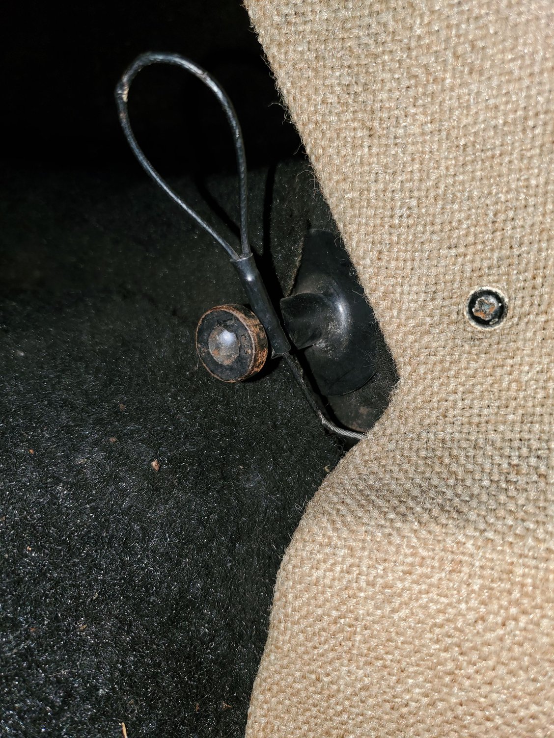

Yes it is electric. It fires a couple solenoids that release the toneau cover. There is one on each side.
The good news is that there is a manual release. If you fold the seat down you can see those solenoids.
Attached o each one is a loop. Pulling on that loop manually releases the cover.

Loop where ?
I tryed the nuetral (5spd manual) and trunk closed , key on ,checked fuses , nothing . Now I'm looking for the loops , am I looking in the right area ? Did you get the other two messages I sent you before this ?

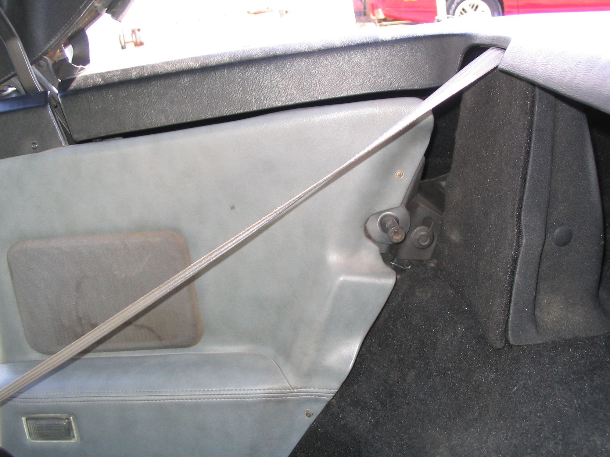

Manual Release Loops: You might have to feel around behind the sail panel. It had been so long since I had needed to find mine that is what I had to do for this shot.

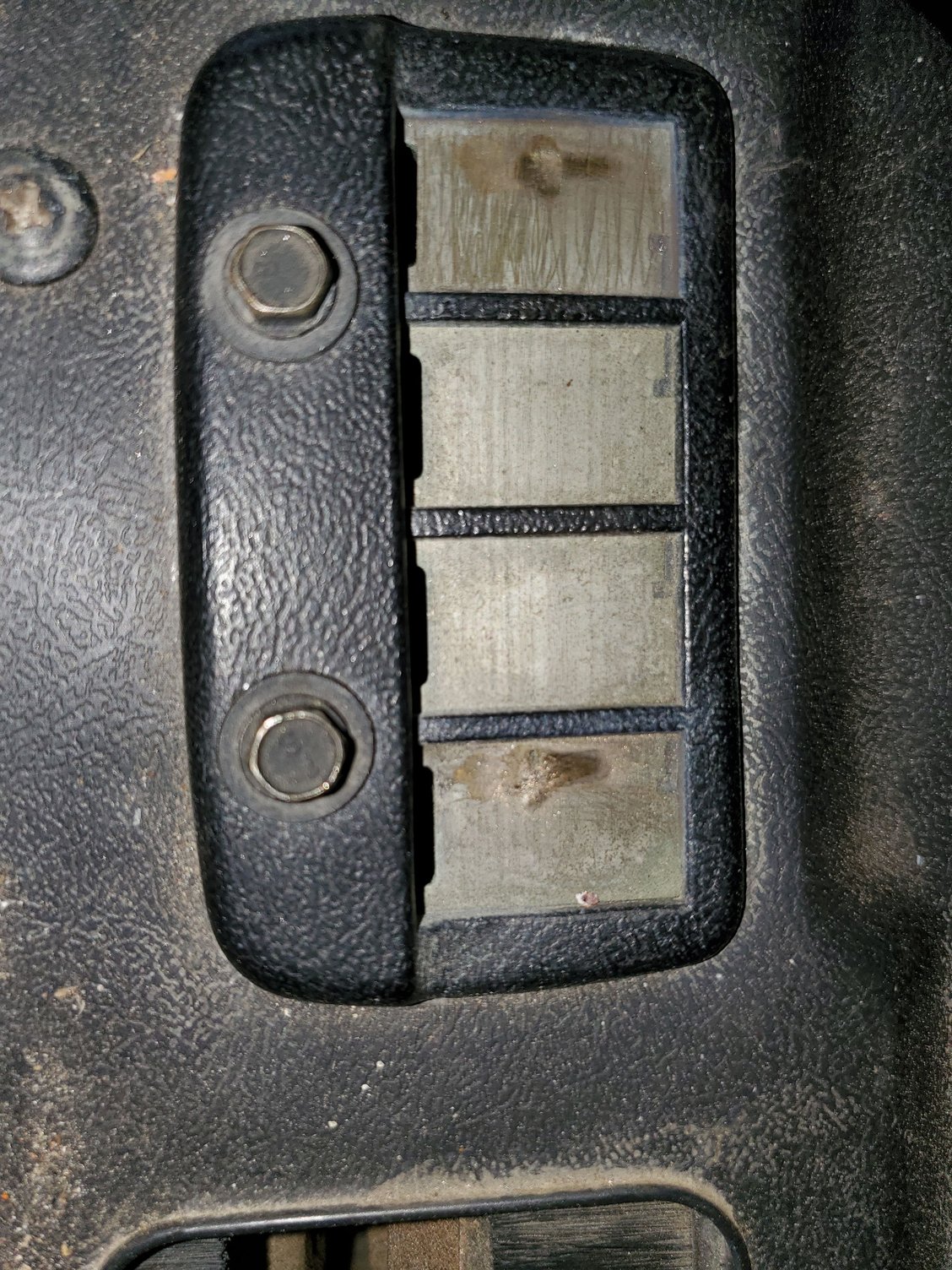

Re: Your Convertibles

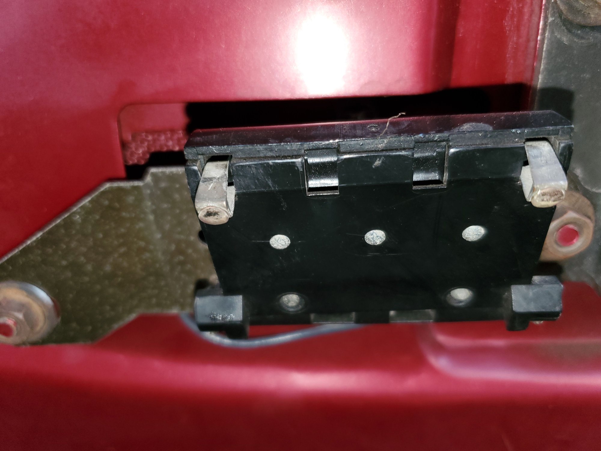

In the trunk you will find the trunk switch. Some of these incorporate a pulldown instead of just a latch. These sometimes malfunction. Here is a picture of the top and bottom parts of this. If you look behind the Back trunk trim you will see the wiring for the trunk switch. You can disconnect and bypass the switch to see if it is the problem. It's purpose is to keep you from raising the tonneau when the trunk is raised and thus avoid crashing them together...

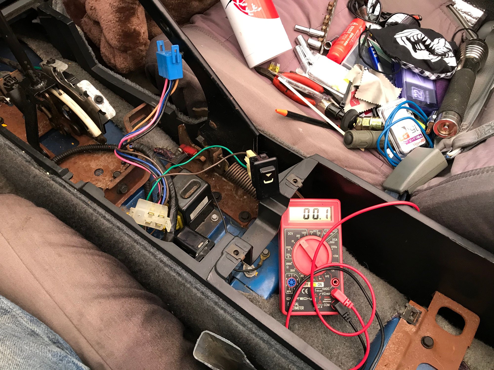

ok....after several years finally diggin into this...mainly cause I finally got hatch pull down working and had rear tore apart anyhow...SHOUT OUT TO West Coast Autoparts for the rebuilt up/down cycle switch. But here I sit not wanting to rip the interior apart to chase the wire from release solenoid relay...any suggestions...good power to relay to switch and through relay.... NO power to both solenoids OR trunk courtesy light which happens to be spliced off right side solenoid power.
