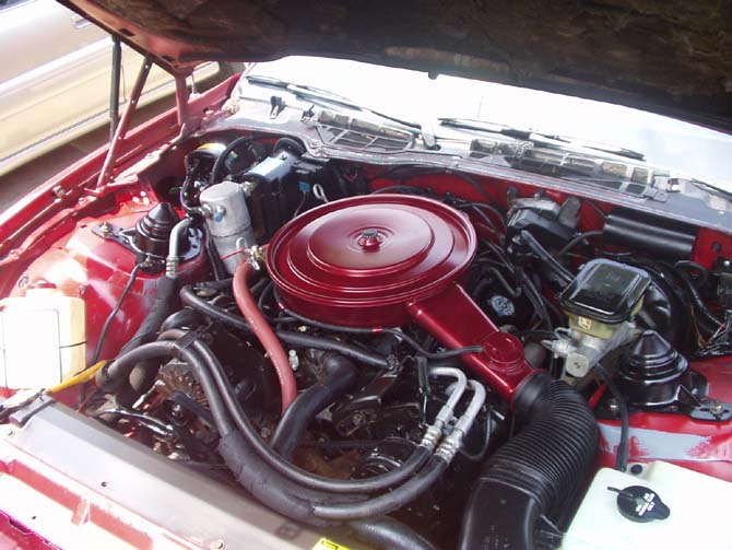

Anyone with a digital pick? What is the accumulator?

the accumulator is the big silver thing mounted on the firewall on the passenger side of the bay. there is a cooling line comming from it, should be between the engine and the heater fan motor.
