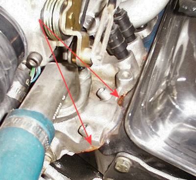

The pic above is the Dex-shyt creeping out of my seals and it also toasted my heater valve. My block is GM new from the dealership and everything else was cleaned by me or new except the radiator which was 6mo old prior to my motor being redone and the heater core which is still original.
Under a severe mental lapse.. I thought the dex-stuff would be worth a try since the motor part was basically like a new car. Apparently the above is what I get for thinking.....

As for leaks such as the earlier picture.....he thinks it was either over/under torqued or there was pitting that didn't get properly sealed.
Too, water pumps failing, the seals were designed for dex-cool on the new cars. You must remove all dex-cool from the system to not run it. He's not aware of any type of flush that can do that. However he did say that draining the rad, heater core, and pulling the freeze plugs then flushing should remove enough to not cause problems.

I am no expert or anything like that. But this is my thoughts.
I really don't hear anything good about Dex-Cool. I hear some people say they haven't had a problem yet. But then again they are probably the people that will buy a car and not do anything to it but put gas in it, until they are over 100,000 miles.
I keep seeing post about Dex-Cool turning to sludge, or eating up intake gaskets.
I have seen alot of pics of what it does do.
I cannot say why it turns to sludge, air in the system, rust whatever. I know it does.
I will give it this much, green will rust if left long enough. However green will not turn to sludge, or eat up gaskets. So why mess with something that can clog up the radiator, heater core, eat up the intake gasket whatnot, when I can put green coolant in, run it with air in the system, not touch it for 5 years, and it's still going to run fine. Yes I know air in the system can cause it to overheat, and 5 years will cause rust. Point being you could add water/coolant, and just drive it.
