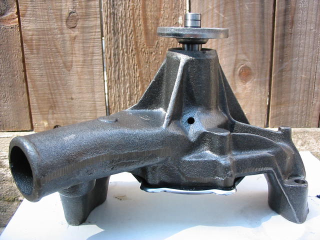

These Stewart Water Pumps are of high quality and I purchased the Stage 1 because of recommendations from searches on this site. Here are some pictures:

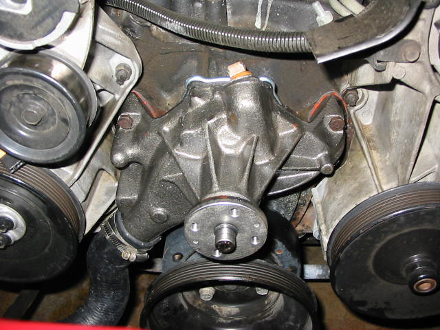

Here's a picture of the Stewart waterpump mounted on the engine:
