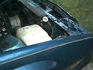

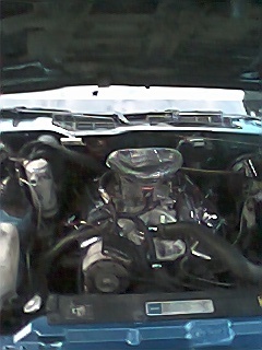

i did a swap 3.1 to a 350 it will idle all day at 180* but when i drive it it goes up to to 230-240 then decides to die i can start it back up but but it rus like s***. i put a 160* stat in it,new rad, coolant is circulating,electric fan is running constantly,i filled the block at the stat and the coolant is running into the overflow container,should i run a fan off of the water pump? whats next?

heres a pic of the rad

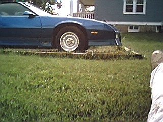

If you look under the front of my car you can see the air dam sticking out a little.

yes i see it, thank you for your help,obviously i dont have one
