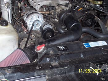

Update:
I have changed the ICM and put a new Battery (Champanion 925 amp) car runs better but is still shutting off when hot.
Tomorrow I am going to check the Cat Converter.
I was running it last night and it seems to be overheating, when I turn the AC on it brings the temperture down. So, my thought is something is not letting the air flow out.
Old Jun 10, 2005 | 12:12 PM
Bill Speed's Avatar
Posts: 1,330
From: MN
Car: 1989 Formy droptop/88 Deville
Engine: L98 350 TPI
Transmission: factory RWD, WS6 susp
Both of those are V6 cars?
In my recent headaches, I've only had over'boiling' as it were, where stop and go and slow moving 'crap'ic causes temps to quickly fester underhood. Driving freeway speeds on cool days keeps temps at bay...if overheating for me, 15 to 30 minutes allows a good partial cooldown and the car will run. Last overheat, there wasn't enough time to wait, and the key didn't offer any startup so I walked back to my work/apart location leaving the car parked off the street. It started once I got back to it after work. I'd say there does appear to be a protection circuit in a critical overheat to avoid severe damage it appears.
I had an 88 Deville where the waterpump was failing and the weep hole was a clear indication. In my Firebird, the gaskets are in dire need of replacement but haven't been able to afford a replacement at present and the heads are suspect of warping and a compression test suggested from my mechanic.
The Deville seemed to exhibit different overheat characteristics and also presented a Shutdown Engine telltale in extreme overheat, so you clearly knew when you needed to park and shut the engine down.
Either way, I keep the econ fans on and venting the hot air thru the dash...on hot days it doesn't help you much, but it does keep that air off the engine.
I don't use my A/C because it has no charge on it...blows hot anyway.
Currently my radiator fans don't come on and I'd had my Cadillacs' fans tested before to make sure it wasn't a fault at the fan, of which I'm thinking the same for my Firebird
Bill
