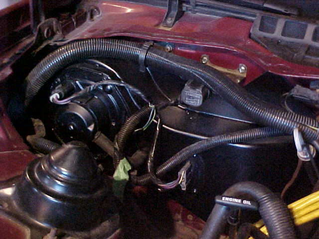

Simple process once you start tearing into it. I did it without directions.
AC:
Have the system properly discharged.
Take the belt off.
Remove the AC compressor and hoses.
Next start unbolting all your fittings that the hoses attach to. There'll be a few screws that hold the hardlines onto the sheet metal near the sub frame.
You can choose to leave the condensor in front of the radiator or pull it out. I yanked mine out. To pull that out I went ahead and unhooked the fans, drain coolant, removed radiator holddowns, and hoses to the radiator. Pull the radiator out of the way and pull the condenser out. Reinstall the radiator.
Next step is to start removing into the parts by the firewall. Basically you'll be unbolting most the stuff in the area. You'll be removing the accumulator (aluminum canister) and unplugging the connections around it first.
I unhooked all the connections on the box next (power/ground to blower and the resistor) and removed the upper bolts for the heater box. There should be 3 or 4 on the top the fourth is partly hidden by the heater core hoses. It's a stud with a nut you have to remove on the right corner of the box. Good luck on that it usually rusts up bad.
I then unbolt'd the blower, removed it, and removed the upper half of the box. That let me pull the evaporator out of the box.
The lower 2 attachments for the heater box are within the car itself. You'll have to pull the carpet back a little bit on the passenger side to see them better on the firewall. There are several there but you only need to remove 2 of them to pull the box out. Their the ones with a large metal washer and some rubber washers. I did trial and error till I removed the right ones.
After that the I was able to yank the box off the firewall.
Reassembly is fairly easy. If you're using a 1LE box you can not use your AC fan unless you follow the spacer instructions on this site. Basically the AC fan is about 1" or so longer than the Non AC. One member used weather stripping to provide the extra space needed. If you go that route you'll have to figure out how to hook up the blower cooling hose to the 1LE box. The AC box had a fitting for the hose to slip on the new 1LE box does not on the box itself it has a plastic fitting that's attached to box. So you're project could be more complicated if you're missing that. The AC resistor will bolt up to the 1LE box, you might have to clearance to the box a little to get it to fit in the hole.
Either way if using the 1LE or AC blower I would still use the AC resistor and harness. If you use the 1LE blower you might have to modifiy the harness a little bit. The 1LE blowers used a 1 prong (power) and a ground to the blower plate. Your AC harness may have this earlier style which should then just bolt up or may be a 2 prong connector. Of which mine had a 2 prong, which the purple wire was the power and the other is the ground. So a new connector on the purple wire and grounding out the blower plate with the other fixed the problem.
If you want to do a true 1LE conversion you'll be chopping up the wires a little bit to use the non ac resistor and harness, which can get a little complicated.
As for the added relay you can leave that if you want it won't hurt anything. The AC motors had a 4 speed setting while the Non-AC had a 3 speed.
So if you get the box from a JY:
Be sure to get the entire thing: blower, wheel, box, and the resistor if you want to use it instead of the AC one.
Lots of people make the mistake of just grabbing the box and leaving the blower and wheel. A lifetime warranty version of the blower and wheel can be purchased from parts stores but look to shell out $20 for the blower and another $20 for the wheel.
I'm in the process of building some fiberglass 1LE boxes. It's been a slow going project.
You'll need to install your new pulley, radiator again... etc.
As for AIR removal:
Basically you'll be unhooking the Air tube connection hoses and using cap ends to close them off. You don't want to leave them open to vent out under the hood.
The pump itself is bolted under the AC compressor. Remove the pump and other attachments. I tied my electrical connections back instead of cutting them incase I wanted to ever convert back. You can use the SMOG delete pulley or use a smaller serpentine belt. https://www.thirdgen.org/newdesign/t...rpentine.shtml
Don't forget to delete or cap off the Lines coming from the Cat(s) also.
You can find more information from https://www.thirdgen.org/techbb2/sho...hreadid=228712
That being said I might have left something out, but I'm tired of typing now.

SWEEEEET!!!! THANKS FIRETURD350 that pretty much says it all! Couple of questions for ya though......
I can still leave the A/C box on the firewall can't I? I realize that it won't have the same purpose but do I have to take the whole thing off??? If I understand correctly, I will only have 3 speeds on my interior heater fan right? I don't find that a big deal as long as it works it is the Great White North.... I guess I'll have to plug some holes on the original box if I leave it.... That shouldn't be a problem. I ask because as far as I can tell the 1LE option was pretty rare up here and finding parts is pretty hard in the junk yard. The same could be said about any third gen around here....

Yeah, I guess you could always just remove the evaporator (don't need it anymore, it'll be added weight now) and plug up the holes on the box itself. Well the boxes are just called 1LE heater boxes, but actually that's just the fancy name for it. Any 3rd gen car without AC has the desired box, not just the 1LE option cars. 1LE heater boxes makes them sound more High performance so sellers have no problem getting $75 to $150 out of a metal shell on Ebay.
If you just plug your holes you'll reassemble the AC box again and you will beable to retain the 4 speed AC blower, provided you do not delete your relay. The 3 speed blowers were just in the Non AC units.
Usually the idea behind the AC delete is less weight and more free space for changing spark plugs, that's why everyone uses the other box. It makes getting to the #8 plug a little easier.
Hopefully in the near future I will beable to offer a cheap alternative to these high priced boxes for all us fellow thirdgen owners.

It depends on what opening you're talking about. The circle by the blower motor wheel is for the incoming air. The rectangle cut area is for the outgoing (into the cabin). In the mean time the blower pushes air across the box into the rectangle opening. That's how the incoming air charge is cooled by the Air Conditioning (it passes through the evaporator inside the AC box). If you plugged the holes up so you do not have any major leaks on the box itself it should work in theory. Of course you'll have a fairly long slot you'll have to fix up nice and pretty (from where the old evaporator slide into the box).
You do not want to cover up the holes on the firewall if you want your vents and heater to still work.

Like I said earlier there isn't any reason why you couldn't keep the AC box if you wanted to take the time to plug the holes in it. But most people ditch the AC box for a AC delete box since it takes up a lot less space and sits closer to the firewall making it a little easier to reach the back spark plugs. Course that means you'll have to either buy the new box, blower motor (3 speed), and wheel. You could also make a spacer to use your current 4 speed motor and wheel on the new AC delete box. In which case you would just need an AC delete box and a custom spacer (which some members have even used weather stripping).

Just thought that I would catch everyone up on this one....... I was kinda confused about the different wiring harness (or plugs) on the 1LE box this is what I did!
I transfered the resisters from my original A/C box into the 1LE box...... no problem there. In this way I could use the original wires from my car. I used the 4 speed motor from my original A/C system and the basket as well! To do this I had to make a spacer to distance the motor and basket away from the firewall because the 1LE box isn't as thick as the A/C box. I used plexy-glass, but I think that you could use just about anything. The metal screws grounded the motor when they bit into the metal on the 1LE box. I think that the only wire that didn't get hooked back up was the one goin to the condensor???
Attached Thumbnails A/C Removal-1le-conversion.jpeg

Looks like a very nice install. I believe the black wire on the 2 connectors to the blower is the ground at least on the later AC designs. The older motor (non AC one) I have only have one connector for power and are grounded through a ground strap (small wire) to the firewall.
