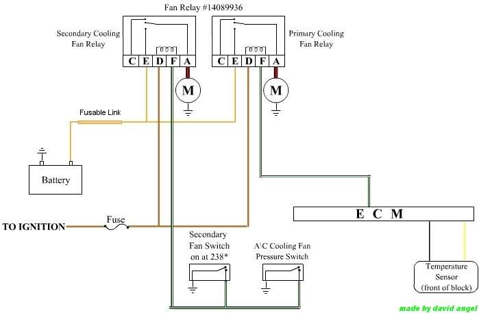

On the passenger side there are 2 lines coming out of the condensor. One goes to the compressor, the other goes along the frame rail toward the firewall, there is a pressure switch on this line. If that switch or the wiring is faulty it could be the cause of your problem
See the attached wire diagram
Edit, looking at the diagram, the ac switch is only connected to the secondary fan, sorry
hopefully the diagram will be of some help

Yeah. It looks like only the ECM has control over it. I know it should have control, cause if I jump the diagnostic port terminals to show the error codes, it fires up the fan. The signal is getting to the relay to turn it on, but how come not under normal conditions? I'm thinking maybe something with the ECM itself?

According to the diagram, the primary fan relay has only one ground controlled only by the ecm, when you ground the diag connector and the fan comes on, that means that the ecm and all assoc wiring are good. Your back to a bad coolant temp switch (doesn't matter if it is new or not), or your system does not allow the temp to get high enough to kick on the fan.
The gage is not an accurate way to read your temp. In my car I set the fan on temp at 215, yet the gage reads almost 250 before the fan comes on.
I'd be willing to bet that it would work if you put in a 195 tstat and stock fan switch.
