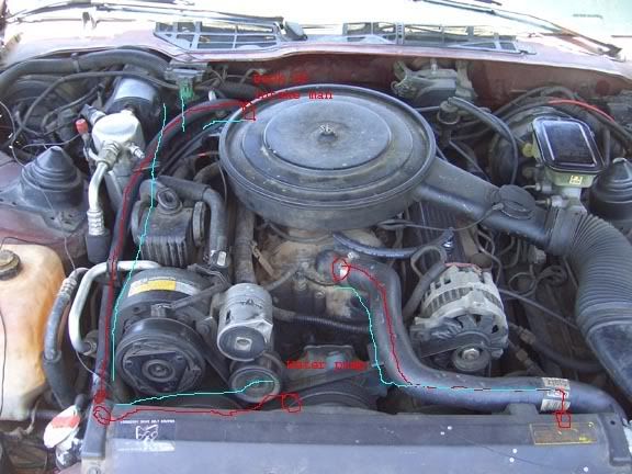

I am uploading some pics now. And ill jimmy rig the pic showing my hose flow!

The blue is the original route, the red is my new route, i bypased the heater core cuz i couldnt get a line off, its a brand new heater core, and i have that rust **** in my system that you see by the fill port, i just lifted that tab and that nasty crap keeps coming out even after i flush it, but it should still get cool, as for the air dam spoiler thingy is that the thing, cuz i dont see how it would really work lol, if i need any more pics ect, lemme know!!

Looks like you put an aftermarket electric fan on. you did make sure it is sucking air with it mounted on that side right? also i would fabricate some kind of sroud to suck more air. I also believe you have the colant flow messed up. The bottom hose has the cooled antifreeze going back into your block, you have water coming out of the pump going back into the outlet side.Attachment 139582

I don't see an air dam. Looks like an non-stock rad cap too. Replace your cap with the correct one, or a new one. Like $5.

Ok so i should replace the cap?? Then whats the black thing scoup in front of the radiator??

STOP@!@@ Hold the flames, it didn't fix the problem, still overheating in town, on the highway, im sure the air dam will help, but shouldn't the fan be sufficient enough for city driving?
I also replaced the radiator cap!

http://www.autozone.com/az/cds/en_us...rInfoPages.htm
Take a look at the routing on here.

My heater core is bypass
, It has come out brown thou like rusty color before ive flushed it like 10 times and it seem to do the the trick, pretty clear now. Ill go get that airdam today, still hard to belive that lil air lifter makes the difference, but once the car comes to a stop shouldnt it cooldown pretty quick then? Thread Starter
