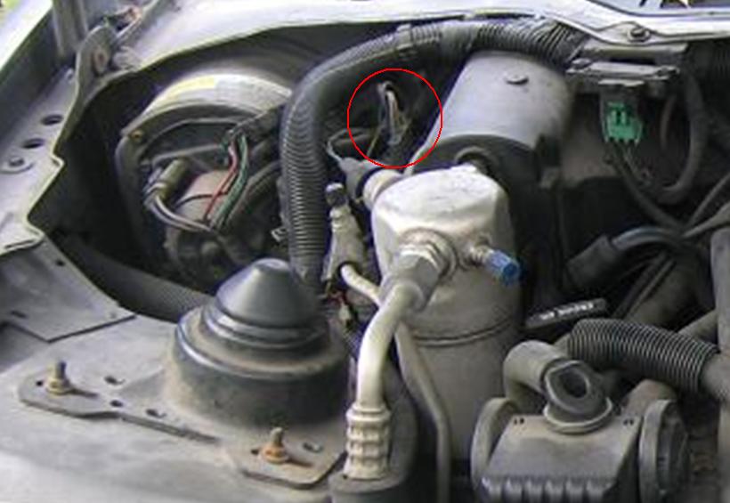

Hello, I am trying to clean up my engine bay and since my AC does not work and most of the components were removed except the canister and the box attached to the firewall. I did a search to see how to do this, and I came across this thread. And so far it was very helpful.
I wanted to know about the wires that are plugged into the AC box, if I removed the canister and the box from the firewall the wires in the pic that I have circled would not be connected. Do those need to be connected for the heater to still work? Right now I still would like the use of the heater and defroster. Is there any thing else that I need to be aware of before removing the box. I saw an article about making your own AC delelte box and was thinking about making one of them or can I just bolt a plate to cover the holes that would be left from the AC box?
This is not a pic from my car, I have not yet downloaded the pics from my camera. I will do that in the next day or so.
Any help would be very appreciated!

keep all the wires until the time you have finished because there's only one set of wires that you can cut and tape, those that were attach to the aluminium canister, the others one must be plug into your new a/c delete box.
the wires that you have circled in red will fit directly in the a/c delete box like this one: http://i145.photobucket.com/albums/r...5/untitled.jpg
When you removed the old AC box do those wires just pass through the old box and then just plug them back in when the delete box is installed? Were there any other wires that I would need to worry about other than the ones that I had circled?

I didn't make it, I bought it from I guy but you can easily buy one at a srapyard or on ebay like this one http://cgi.ebay.com/ebaymotors/82-92...yphotohostingà
yes for you first question and for you're second, yes, the one who are connected to the little relay box. In other words the only one that you can cut is the one as on your pic, those that are connected to the aluminium canister (those which touch your red circle)

I think you are right that the best way would be to do it the way you did it. But I am on a super tight budget, so if I cant get that one off of ebay cheap (hopefully not alot of people see this thread or are looking for one on ebay) but that is why I am thinking about modifying what I have.
Again thanks for replying to me with your pics and experience. I thought it looked like separate pieces.
I took your pic and I have another question. Is the piece that I have circled red easy to remove?

Re: Remove my A/C !need help!
there is 3 screws that retains it by the interior (off course the passenger side) you have to remove the plastic cover ( 3 srews) and then, if you pull a little bit the carpet at the bottom, you will see the screws that you have to remove
no problem, it was a pleasure for me to help you. while I think of it there is 2 srews by the interior, the other is in the engine bay just beside the rubber pipe of your heater core connected to the fire wall.
