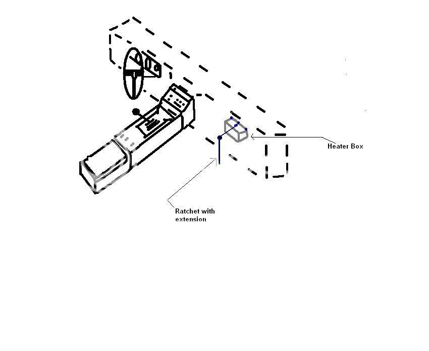

There is really no reason to remove the dashboard. I changed mine in about a half an hour. You just need to remove the kick panel and use a 6" ratchet extension. There is only one tough bolt. It's the upper middle one. Just slide the extension in there and you can guide it with your other hand. When you put the bolt back in use a little chewing gum or whatever to hold the bolt onto the socket and set it back in. Here's a crude drawing.
