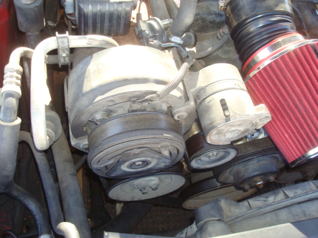

Hi I want to remove my A/C compressor and pulley so i can run my dual 4 inch cold air intake. I was wondering can i remove the compressor and run a smaller belt and leave the tensioner pulley on? and if i remove ONLY the compressor will my heat not work? I keep hearing about the heat and an A/C Delete Box and A/C Delete Pulley.

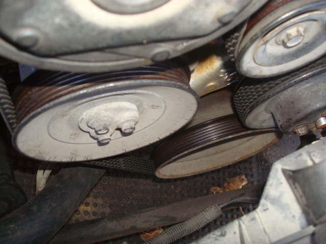

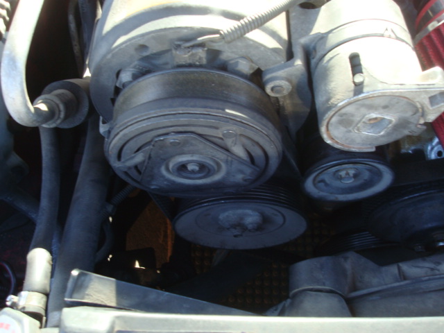

I fergot to add it is a 305 TPI anbd here are a couple pics.

Removing the AC system will not affect your heat. If you plan on just running a smaller belt, be sure to run it the same direction over your water pump pulley. You do not want to turn your water pump the opposite deirection. If you have trouble with using the tensioner, you could always put an adjustable alternator bracket on.

You can remove the compressor and run a smaller belt, it won't change anything as far as the direction or routing of your belt. Do remember, however, that you will not have the defrost function anymore as it uses the a/c system to remove moisture. If you are going to remove the compressor (therefore not have a/c) you might as well go the extra mile and do the complete a/c delete (condensor, evaporator, hoses/lines, etc) and then smooth the firewall.

To the OP - I'm not sure you can get away with a shorter belt. I was able to on my 92RS with the 3.1 because my alternator is on the top left of the engine. I ran the belt around the water pump, then under around and over the power steering pump and back over top the water pump, under the tensioner to the top of my alternator. IIRC, that is where your A/C compressor is. In order for the tensioner pulley to work properly, there has to he something in that position. It's going to depend on which direction the tensioner moves to apply the tension. You can remove the rest of the A/C and leave the original blower motor housing in place. It will still work fine, but it won't look as nice as the A/C delete box would.
I`m not sure of the differances between the serp. set-ups in differant cars or trucks.My car has v-belts set-up.My 89 K1500 4x4 has a serp set-up.I was able to get a shorter belt to work when my smog pump pulley locked up and I removed it.The sticker under the hood even shows you how to run the belt without the A.I.R pump.I would imagine you could do something similar with the a/c as I doubt every serp set-up had a/c.Did GM use a delete pulley for non a/c cars or run a shorter belt?I`m not sure just wondering.
