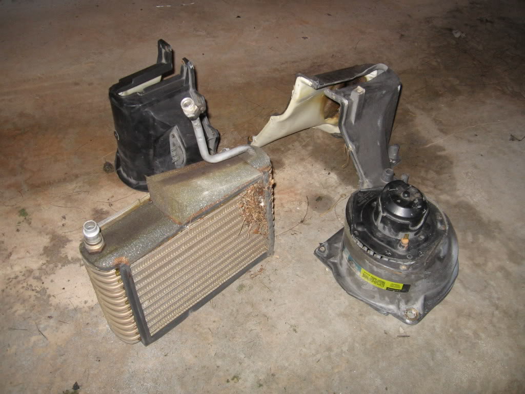

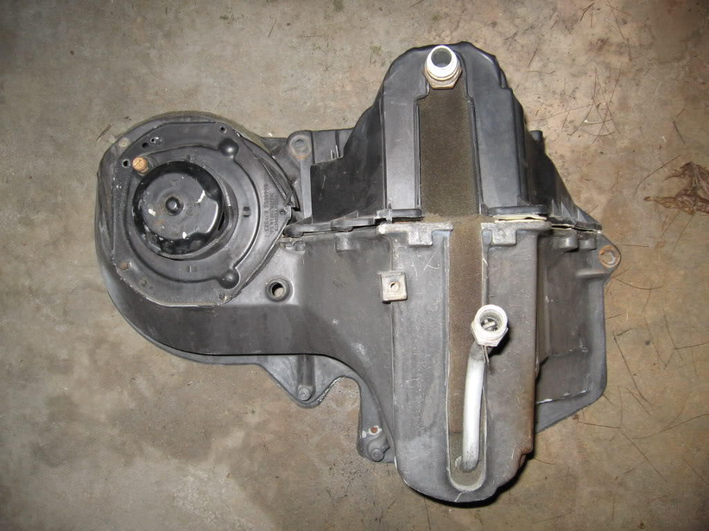

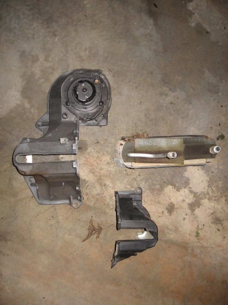

Pictures as requested
This is how the box would look in the car
With the top cover taken off
With the radiator like thing pulled out
Another view of it taken apart
View of the backside of the box all assembled
What i would do is unbolt the entire box from the firewall first and break the seal. Then pull the box forward a bit and undo the top part of the box. Pull the radiator thing out and then you should be able to get the box out with no issues. Hope that helps.

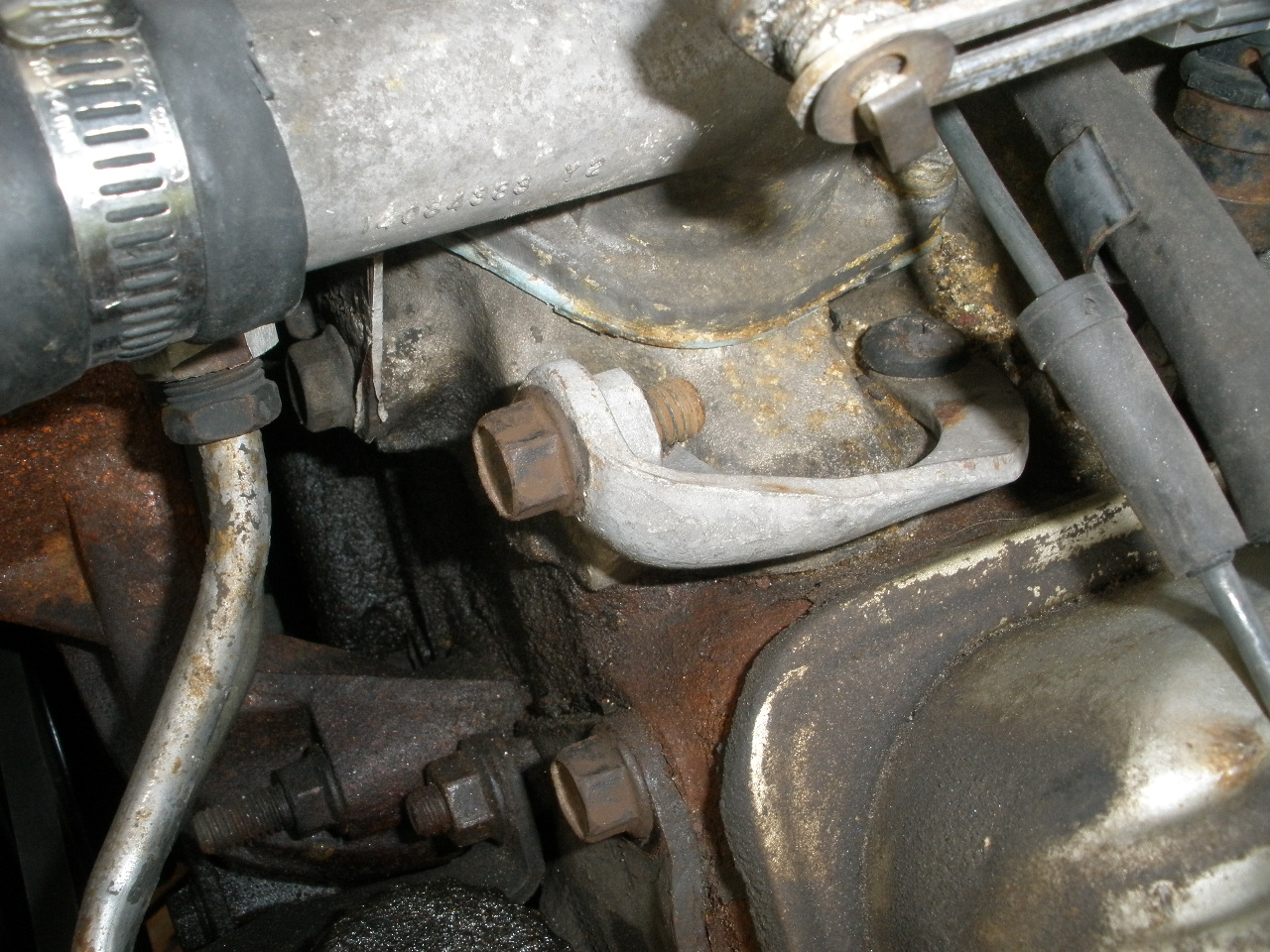

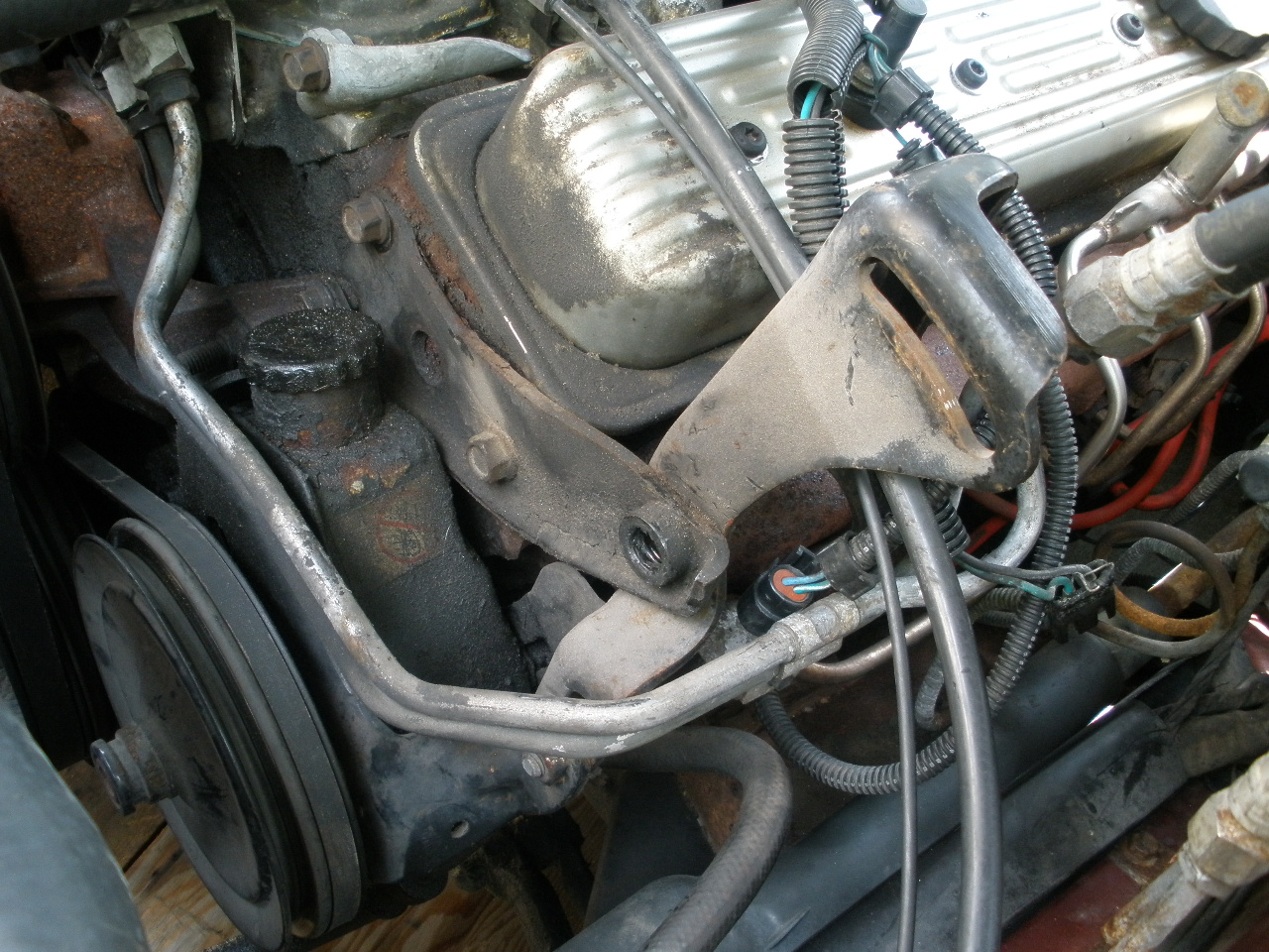

I also have a question about the compressor brackets. Keeping in mind I don't have the serp setup since mine is an 87, there are some brackets that hold the alternator in place, but they also stick up into nothingness looking pretty darn out of place. The only thong I can think off is getting the bracket from a car that didnt have AC and didnt have a serp setup, or I would have to cut weld and grind on the stock bracket to make it tuck away and look factory (I dont want to do this in case i would ever put it back on for some reason). If the rain stops I'll snap a couple pictures to show what I'm talking about.
Mike

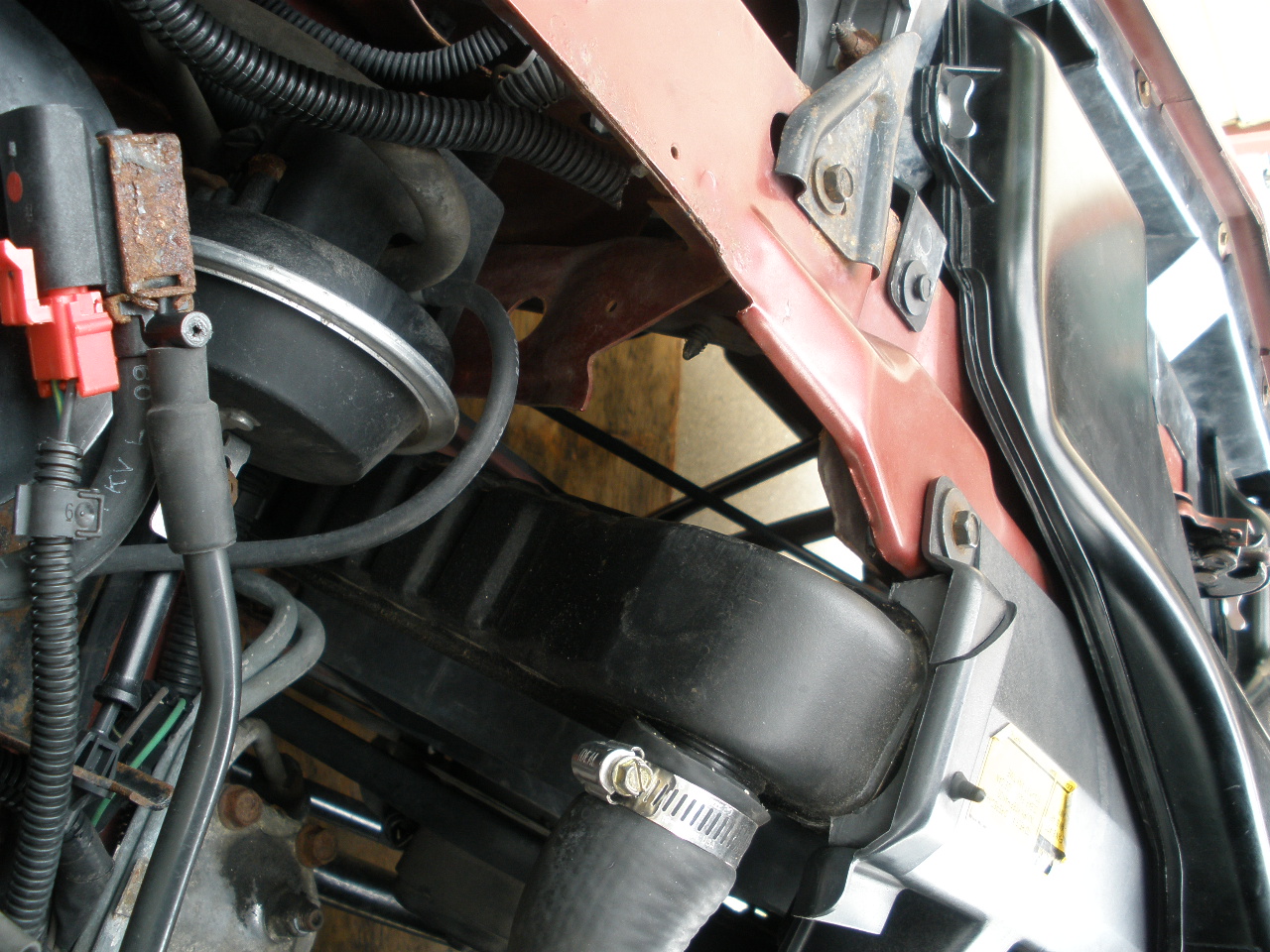

Does anyone think that the gap left between the radiator support and the radiator itself is worth covering with some plastic or metal shroud? It just seems too big and that it would allow a lot of air to bypass the radiator. Here is what I mean...

I'm just curious about this. Is there any reason to keep this now the that AC compressor is out of the car? Can these bolts be snugged up against the intake manifold with out using a spacer once the U shaped piece of aluminum is out?

Yeah that's too much of a gap. The cars came with some plastic pieces that block the air. You should be able to find them at your local yard and if not, I do have an extra set.

If you don't mind, could you post a picture of them so I can get a better idea of how they fit in the car? I'm asking because I have some aluminum scrap I was going to use to make the shroud/funnel things.

Eh i have the same amount of gap and i have no problems with overheating. In fact mine runs a ton cooler than my old camaro that still had A/C and was completely stock under the hood.

I have an '84 T/A that is a factory heater-only car. It has the same gap in front of the radiator. GM didn't seem to be worried about it, atleast on the early cars.
For the power steering pump bracket, I have one that someone cut off the top part for the A/C compressor. You can have it for the price of shipping.
