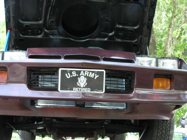

In your pics, I see the top piece of the air dam(the black plastic part) that attaches to the underside of the lower radiator support beam. There should also be a lower piece, the air dam, itself(another black plastic part), that should attach to the bottom of the top piece, but I don't see that in the pics. It's that lower piece that deflects the air up to the radiator when the car is moving. Without that, the car will heat-up at highway speeds. I guess it doesn't happen at the track because those 12-second passes don't last long enough...
Regarding the blowing-off of the lower radiator hose, I doubt there's a spring in that lower hose, right? It looks rigid enough that it wouldn't be sucked closed under pressure, but I'm not familiar with that type of hose. So given the power of your engine, and the pressure it's probably capable of building, I'm wondering if that type of hose, even as rigid as it apparently is, would collapse under enough pressure without a spring inside of it. I suspect it would. And if it's getting sucked closed, that might explain the over-heating in traffic. And that would also explain why, after enough pressure builds-up above it, it would blow-off, which I'd think would happen at the track.

The one thing I notice is you don't have the cover in front of the radiator. This is mine.
Mark.
So your saying right under the radiator the black/brown plastic is part of a air
dam mount. I can't find any pics of a Berlinetta with 1 to see what the hole set up look like on this type of car.
Mark.
Thanks for the pic can you send me pics of all parts needed lower and uppers
I have a 82 chevy service manual and the assembly manual I do not see anything like this man. I'm going try to find air dam parts when I no all I need before a start changing the fans and hood. And the infrared thermometer going to pick 1 AC parts place.

Yes, right there, that's where it should be if a Berlinetta is supposed to have an air dam. But I just searched the net, and I looked at about 50 pictures of Berlinettas, and none had a clear enough shot of the underside to be able to see if they have an air dam, so I was beginning to think they must've used only the body segment that curves underneath the radiator as its only air dam, rather than the typically-attached air dam that all the other models have. But then I finally found one picture where you can see the air dam in the middle, directly under the radiator, which might be why it's not visible on any of the angled-side shots I looked at.
So here's a pic of a car I found online... you can see the air dam hanging down, underneath the radiator. And in the link I posted there's a picture of that part on Hawk's website, shown for Camaros.
So a Berlinetta may or may not have come with an air dam, I don't know, but I'd think it would've. And if it did, then your car doesn't have one. It helps direct air up to the radiator when the car is moving. But looking at all the open airways to your radiator, the lack of an air dam might not be an issue for your car afterall. And if the car's only moving for 11 seconds, then it won't matter anyway.
http://www.hawksthirdgenparts.com/ca...torairdam.aspx
Thanks for your help and the pics man I been home all day looking in to the heating up thing in the engine bay, and try to find more info on the berlinetta front air dam and how it mounts. I could not find 1 real good pic of it mounted.
Going to keep as a weekend car not to much as a track car, I buddy of mind was racing ford gt mustang they guy had used to much nos motor went up in smoke he lost control of has car and ran in to the back side of my buddies
69 camaro SS 383 man both cars total they both work away ok, Kinda slow me down on running this car at the drag strip now.

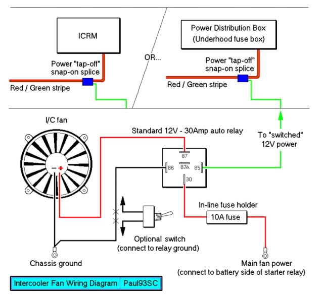

this a pic of my old fan temp control adjustable, to used the mark 8 fan I just added 70 amp relay my old temp relay turns on the new relay that has the high power running to the mark 8 fan.
[IMG][/IMG]
And the 70 amp relay Cole Hersee Co part number RA 700112 RN paid $4.69 this is the 4 pen relay.

How did you wire it up? I have some taurus fans I need to wire in and I'm a little hazy on the wiring...

Yes wire it up for now just have to clean up the wiring. You will have to up date your alternator to 120 to 140 amp. And make sure use a relay that is 70 to 80 amp...
