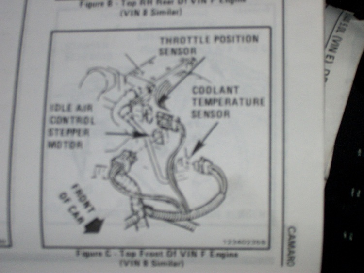

This is a pic straight from my dealer service manual. Its kind of hard to see, but it shows the temp sensor on the front of the engine, a little under the throttle body.

Yea, there are three "coolant" sensors total. One for the ECM, which is the one you guys keep pointing out, another on the pass side head which is the fan switch, and the third is for the gauge, on the driver side head

I only found the 2 in my manual, the fan switch and that one. I see no other mention of a separate one for the gauge.
