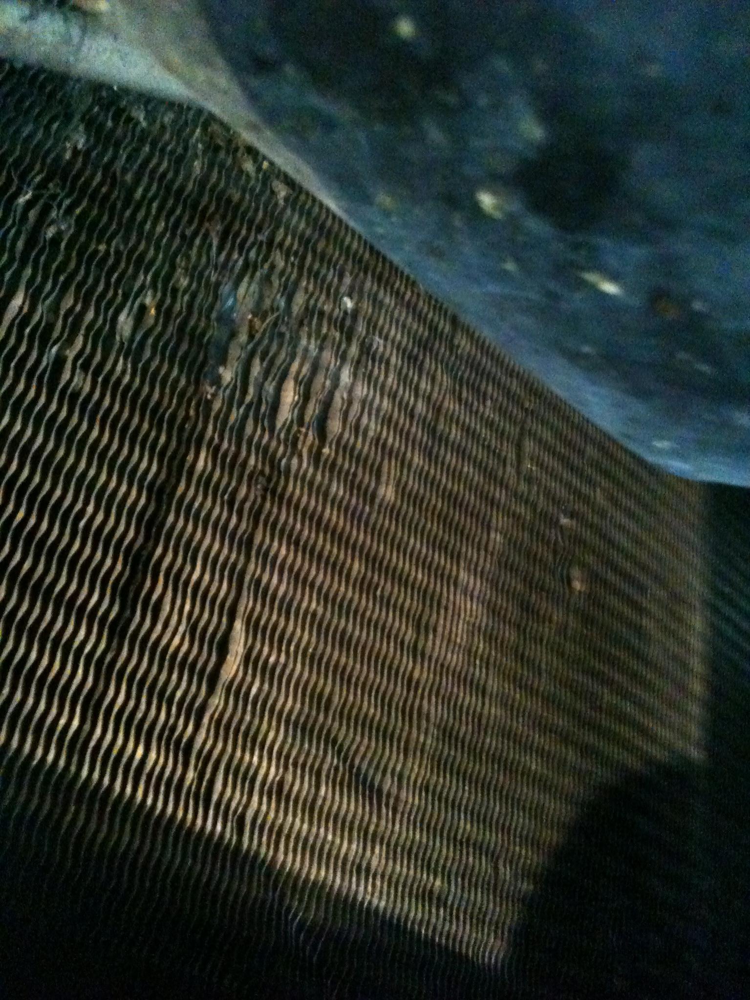

Here are where the leaks occur: as can be seen, the condenser took a hit in the past. The compressor is also weeping a bit at the holes. A week from Monday I'm taking the car in for a condenser swap (a 6 mm version) and a compressor seal replacement. R12. My hope is that this fix will be the solution to a long-running and annoying problem.
JamesC

your condenser looks better than mine

My condensor is pretty beat up and on its last leg. Doesnt leak yet, but its only a matter of time. If this "6mm design" one works atleast on par with the stocker then its worth replacing.

Re: R-12 and Parallel Flow Condenser
I should have mentioned i have an aftermarket alum rad with 2 electric high flow fans. But i plan on swapping in this condensor and running autofrost for some bone chilling vent temps....
