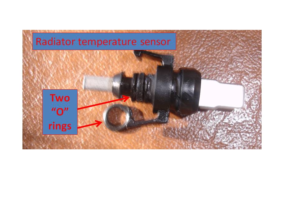

don't know if you got a new champion radiator but I bought an "American Eagle AE951-AA" 2 row aluminum. 82-92... after cutting rubber saddles was direct fit... really great except the dumb sensor prong leaks... since it is in the car I will be trying you solution!

The sensor came off w/tlc... manufacturer used defective "O" rings... each one had cut/flat sides... used some blue rtv... part cooperated & went in just before the big hammer!! Looking forward to driving tomorrow afternoon after rtv cures.
Attached Thumbnails Coolant Temp Sensor plug-temp-sensor-o-rings.jpg   Coolant Temp Sensor plug-repaired-temp-sensor.jpg

It's an unused (on most 3rdgens) low coolant switch.

I seem to recall that low coolant sensor being used only on GTA models. I think. I believe the digital dash has a light for low coolant. I could be remembering incorrectly though.

That's what I meant by 'not used on most' as, digital dash cars with a DIC (driver info center) are not in a majority of f-bodies.
Also, it is a switch (it is on or off), not a sensor.
