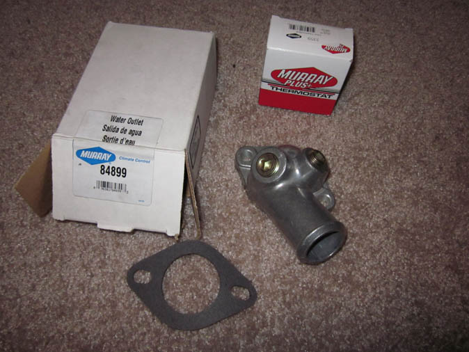

Sooo I ended up going to Oreilly's auto parts and ended up getting these items. I didn't check the updates messages until tonight. It's not made out of cast iron, but I don't know. Anyways, take a look. Should this be okay? Or just take it back?
