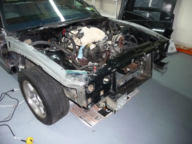

I am taking apart my car to restore/rebuild it. Currently trying to remove everything from the engine bay so I can repaint it and drop in a new engine/trans combo. I will need to remove all of the AC equipment (see photo). I called a few places and I don't think anybody can discharge cars AC at your house. You must take it to a shop due to size/cost of recovery equipment.
Is there a way I can remove all of the AC equipment as one unit and set it aside? I don't think this is possible since AC radiator unit is attached to compressor with hard lines. Would be hard to safely rest it on ground. If not, could I crack a line/valve and bleed the freon? I would loose my R12 charge but be able to take AC items off the car and store them. I am not sure how much R12 I have left. Maybe I could bleed a valve first and see how much comes out. I've read that you can rent small vacuum pump and gauges at Autozone to get rid of moisture before you store AC equipment. Any help would be appreciated as I am at a stand still removing items from my engine bay until I get this resolved.
Please no posts about EPA regulations or how bad venting R12 is.

Re: Remove entire AC equip without discharging? (Update)
robvano, I easily found some car ac/radiator places around me that will recover systems. I tried to look for a mobile service but could not find one.
Well I finally made some progress this weekend. I tried purging via the schrader valve to see how much coolant was in the system. Not much gas came out of the high pressure port and I was able to bleed it off after a few times. Removing the ac/heater core cover from the firewall was a pain due to one bolt by the passenger header. Luckily the nuts attached to the screw were only hand tight. When I removed the cover, I notice that there was debris and pine needles inside the system. You can see in the one picture that the lower seal was not seated properly and let this junk in.
When I first bought my car I did not use the AC too much. It did seem a little weak when I did though. I also notice water underneath the passenger side carpet. I thought that maybe I had a crack around the windshield molding or firewall that was letting water in as the padding behind carpet by your feet would get soaked. I did not want to leave the car outside to find out it the water was due to rain or a ac/heater core issue. I don't know if the improver seal would cause that much moisture to get into my AC system. Think I will take apart the dash so I can check out the heater core area. I noticed that there was some dust inside the firewall assembly and the metal fins have started to rust. Not sure if these have to be cleaned or replaced to have ac work best.
I did some reading and there are two aftermarket R12 hybrid coolants that are supposed to work with R12 systems and not require a full conversion. I think I will try one of these and reuse the compressor as it appears in good shape.
http://freeze12.net/
http://autorefrigerants.com/co00033.htm

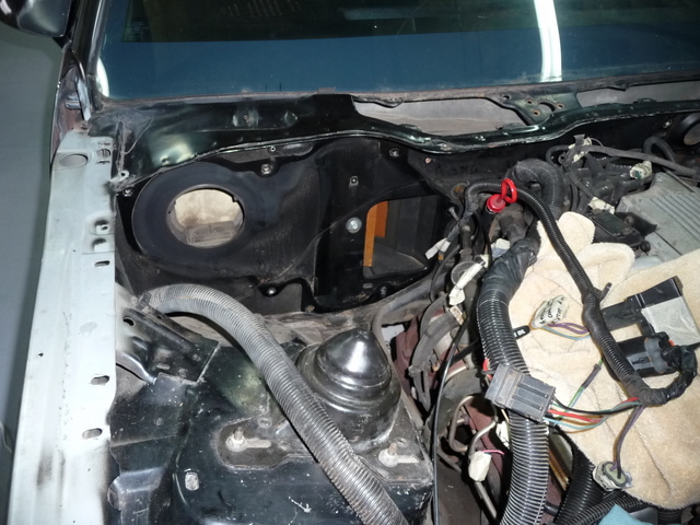

Been there, done that.
A couple of tidbits that I hope will help.
Mine is a Formula, so the dash facia is quite different,
but I'd bet that the underlying construction & factory assembly
techniques are highly similar.
That being said, when removing the dash, it comes out MUCH
easier as a unit (with all the wiring, switches & ducting), than
trying to remove the internal components from the top (underneath
the dash pad). However, this requires separating the main wiring
harness at the bulkhead connector, and secondary connections,
(brake, ignition, turn-signal, cruise, courtesy lightsm etc.),
as well as the left side harness (tail lights, fuel tank, rear speaker),
and right side harness (rear speaker). This will also reveal any likely
wiring chops by previous owners.
A good way to test for heater core leaks is with a standard radiator
pressure tester, usually loaner from the major parts franchises (O'reilly,
AutoZone, etc.) You'll probably need to remove the carpeting, and
possibly the firewall insulation to see the leak. But if you have already
detected internal water, this is probably necessary to address those
issues. This will also reveal any floor pan rust issues.
When you get this far, removing the internal heater box is a simple matter
of 4 fasteners: two on the bottom of the box inside, and in the eng.
compartment, one nut on the side of the AC box, and one fastener inside
the AC box. I know the history or my vehicle, and the owners (brother
& sister-in-law) took good care of the vehicle. However, the inside of
the heater box was dismally dirty -- mildew, gunk, etc.
A thorough cleaning and applications of RustOleum and insulation will
greatly help cabin air air quality.
Hope this helps.
I took pretty good pics of all this along the way, so post up or PM if you
Hope this helps.
need anything in particular.
Good luck.
