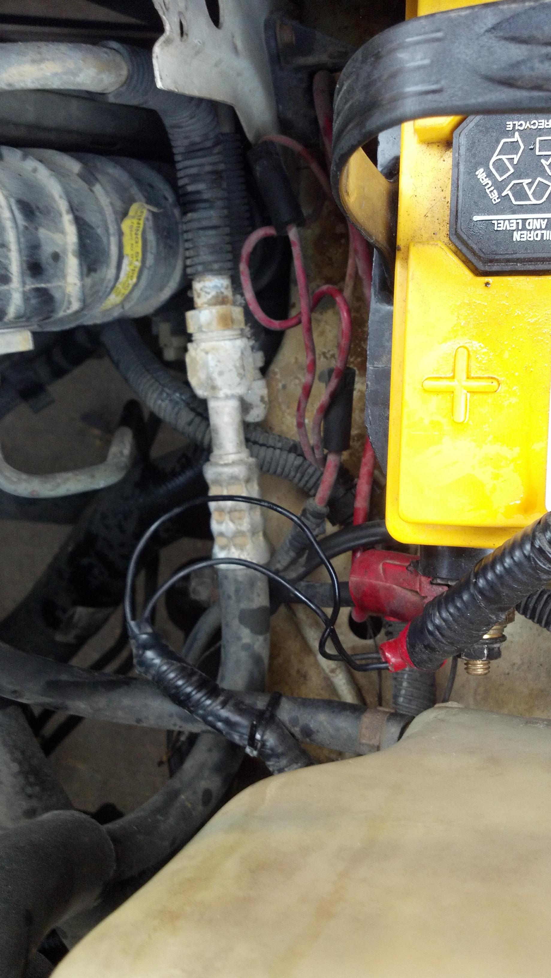

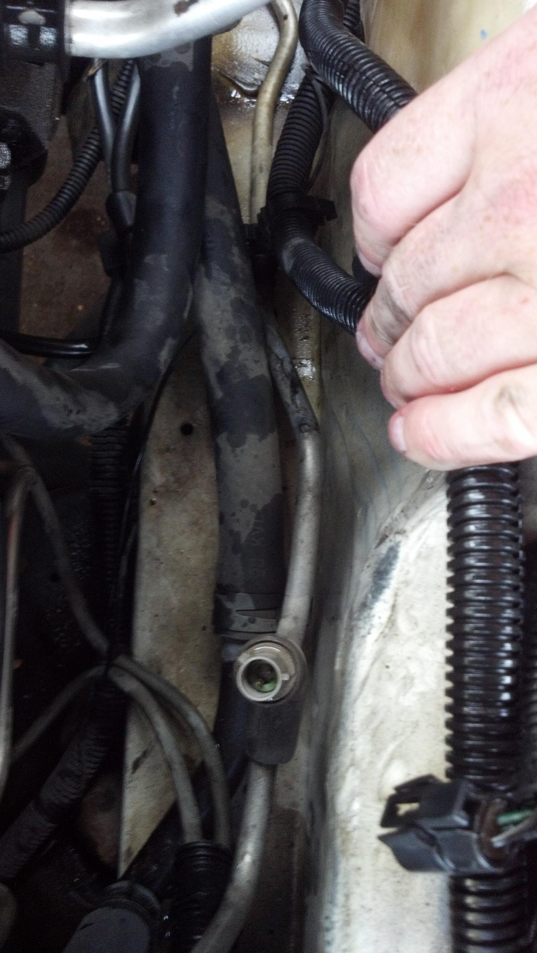

I'm lost where to find this stupid High Pressure hose that goes from the Evaportor coil to my Condenser coil. On this steel line it has my high pressure port along with a pressure sensor on the high side. I can find the hose that goes to my compressor every where but not the other.

Here it the aluminum house out of the car. I tried to re-thread it with a tap and die but didn't have luck because the OD was smaller than the fitting for R134a...

Found an guy that works at Ape Discount Auto Care that made ac hoses on the side and was able to make a high pressure line out of rubber for me. Seems to work fine tho I did put dye into it just in case I find another leak else where in the system. What's odd it when I had to replace the other suction and discharge line that comes off the compressor. The hose was much thinner wall. When I performed an draw down to boil off everything in the system the hose collapsed on it's self. The old R12 line was stiff and didn't have that problem... The new line tho says R134a so I'm unsure if it's really a cheap replacement or that's what the new R134a line are supposed to do...
