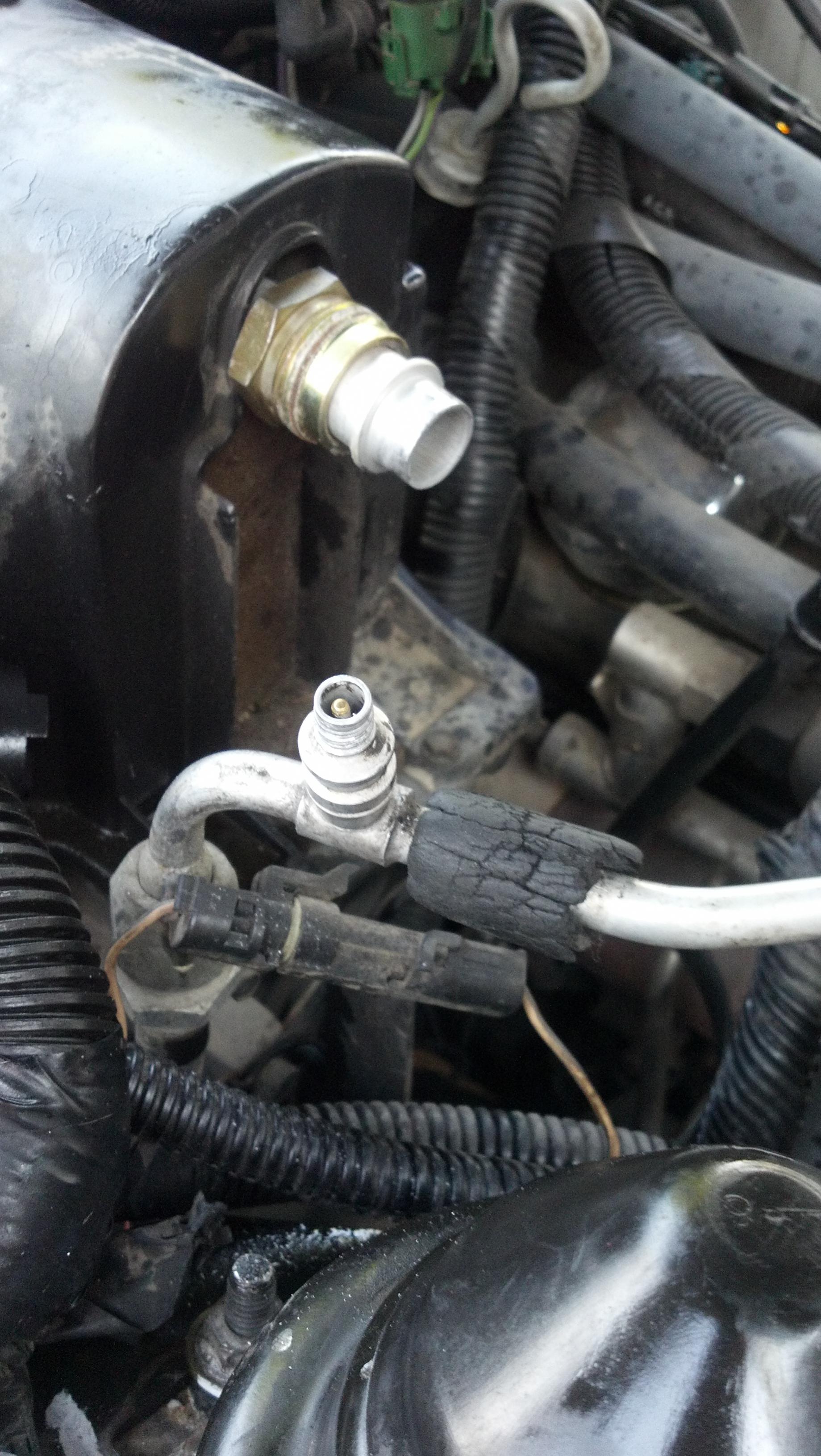

Oreilly Auto Parts has the compressor for $129.99 Well anyways my compressor has the death rattle and finally hit the dust and was locking up on me... When I went to check the low side it was fully charged. So I put the High side on and the dam fitting came off the hose. So I tried to put the fitting back on but the threads were all gone. So this house now needs to be changed. Well no one knows the part number or knows how to get it or where.

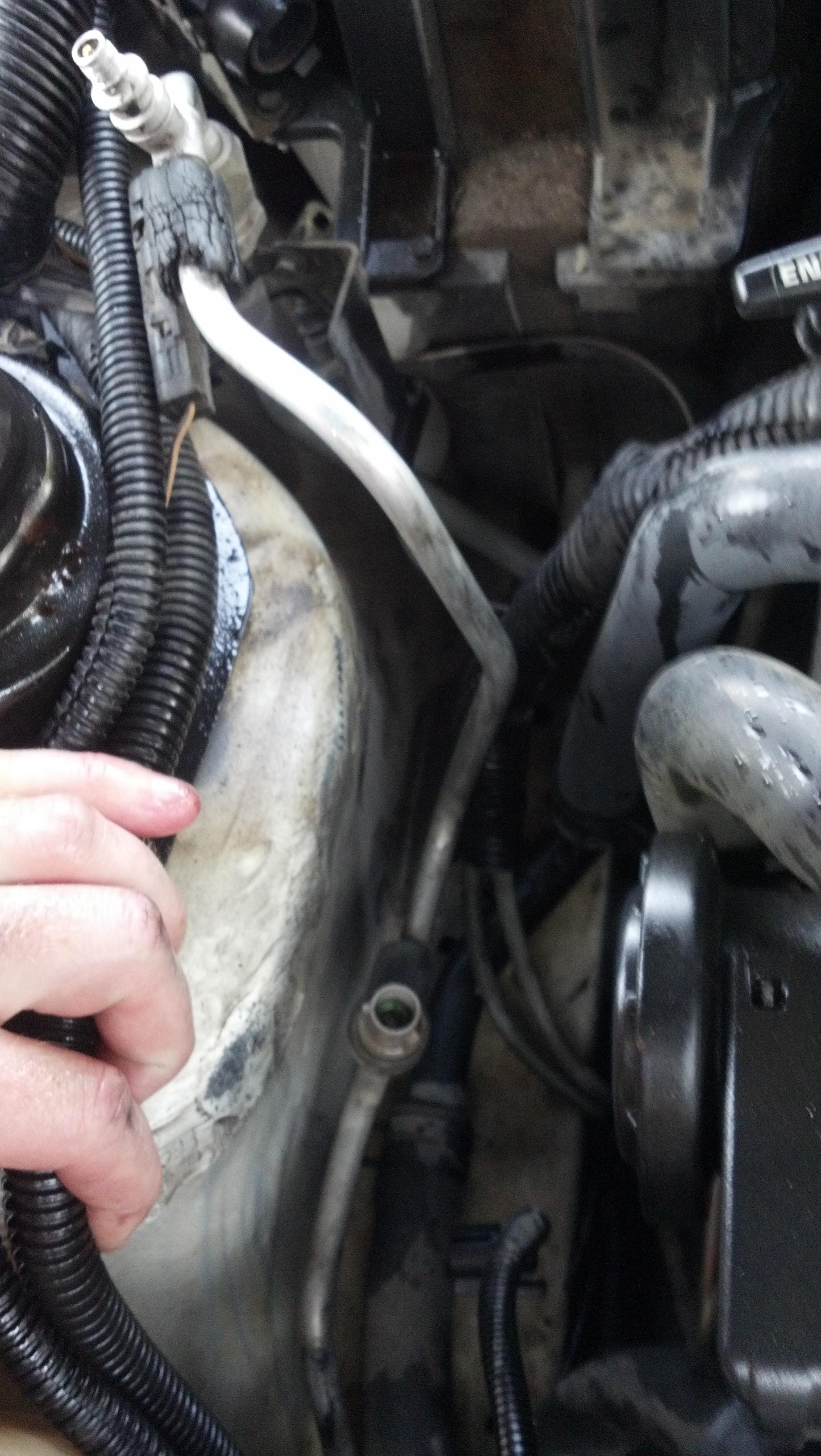

I'm lost where to find this stupid High Pressure hose that goes from the Evaportor coil to my Condenser coil. On this steel line it has my high pressure port along with a pressure sensor on the high side. I can find the hose that goes to my compressor every where but not the other.
FYI it was 107 (that's not the heat index either) today when it went out and it's almost impossible to handle that kind of heat in traffic (rest of the week it's supposed to be over 100). Any help will be greatly appreciated.

Tired Rockauto.com and they didn't have the part either... Going to pm the person.
@Richboll
The facebook link is a dead link... But the other one I couldn't have said any better timing on needed the parts. I sent him a message to see hopefully he still has the hose I need.
@Richboll
Re: A/C Compressor Replacement Tips & Tricks
Found an guy that works at Ape Discount Auto Care that made ac hoses on the side and was able to make a high pressure line out of rubber for me. Seems to work fine tho I did put dye into it just in case I find another leak else where in the system. What's odd it when I had to replace the other suction and discharge line that comes off the compressor. The hose was much thinner wall. When I performed an draw down to boil off everything in the system the hose collapsed on it's self. The old R12 line was stiff and didn't have that problem... The new line tho says R134a so I'm unsure if it's really a cheap replacement or that's what the new R134a line are supposed to do...
