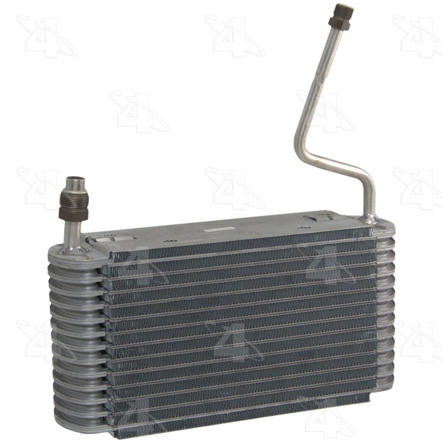

I would say its broken. I am setting up my AC with a new evaporator and that line is part of the core. It will bend but it should not be loose.
The curved line is the bottom line
